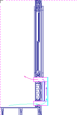

The attachment is something I have seen various forms of.
A box is built with insulated sides and back and glazing over it. The back side is painted flat black to absorbe solar btus. Vents are run through the wall from floor to puickup cool air and out under windowsill to discharge the heated air into the room. Louvers control airflow. It is something that will retro fit into existing places to add some extra heat in circumstances like this.
I worked building a fire station that had a similar semi-passive solar. The whole back south facing wall was a series of these with corrugated backs. A couple of fans ran on a thermocouple to circulate air through only when it reached a threshold temp. That air was ducted through a series of pipes in gravel under the slab.
A fire station doesn't need to be heated to a high degree. As long as the water doesn't freeze, the trucks don't complain. They don't need 72°F
But I'm told that the exterior temps were usually below zero before the normal gas heater came on to heat space due to this system..

That passive solar block would help, for sure. I assume the louvers are closed in the summer to minimize heat gain. I like taking the coldest air off the floor, but would rather see the inlet and outlet at the same height, dropping into the solar box.
Then, during the night, cold air would stagnate low and, without any convection, heat losses would be minimized.
If his cabin has a downslope on the south side, a detached solar panel could be installed on the ground and connected with insulated ductwork. The thermosyphon would work to gather heat when it could and stop losses at night.David Thomas Overlooking Cook Inlet in Kenai, Alaska
