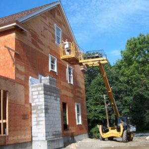

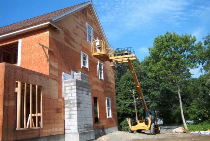

            Like this:
            View Image_______________________________________________________________

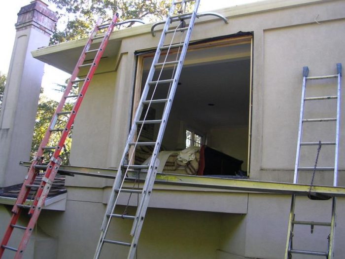

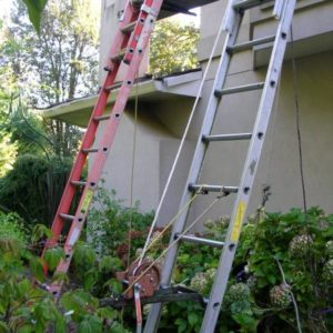

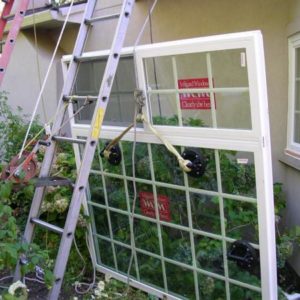

    We use a wench that has been welded to the bottom a ladder jack. As you can see in pic. 2513. There is a pulley at the top of the ladder (pic. 2514). picture 2517 is a close up of the wench assembly. We use Woods Power Grip 8" suction cups to attach the rope to the window. See picture 2518.
    You will need to have enough height above the r.o. for the pully that is attached to the top rung of the ladder. The window we were lifting that day is a 6060 tempered unit and took 3 guys to get it in place. We can usually wench it right into the opening without to much effort. We have lifted quite a few windows with this set up and haven't lost one yet. Just make sure the suction cups are in good working order. If you would like more pix or have any questions let me know. Hope this helps.
