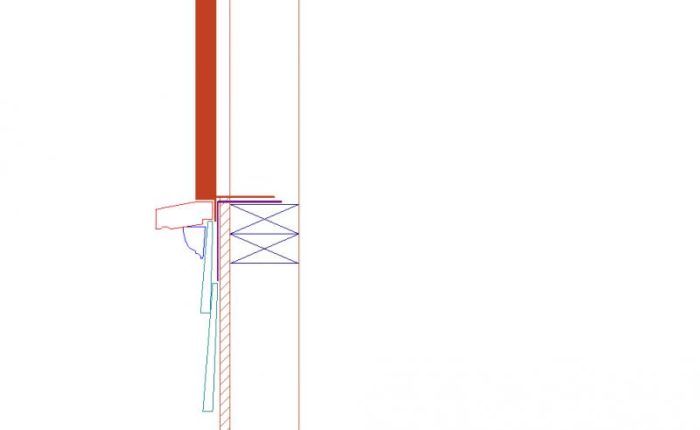

  2. Piffin | May 28, 2008 12:55am | #2
    Drawing I found I had already from a previous similar discussion.
    It shows a dado lock for siding also that is not always needed.

    2. lojoma | May 28, 2008 03:35am | #6
      What kind of trim is that in blue under the sill piece? Is it needed for strength, like the trim under the stool on the interior?Thanks for the info, by the way...I did see that diagram but wasn't sure how to make it!
      1. Piffin | May 28, 2008 08:33pm | #16
        That is an apron piece, and goes on after siding.
        How it is detailed depends on the style of house or whatever else I am trying to match.It does help support the sill, but is not necessary
