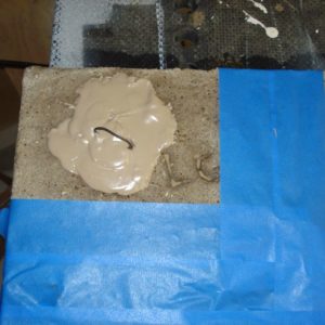

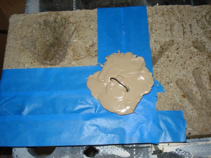

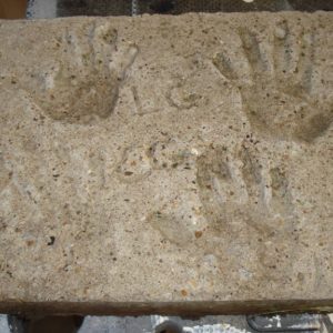

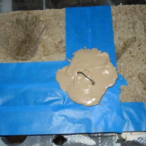

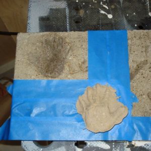

    Wow, that popped out much easier than I expected.
    I can make the casting of the imprint and then you can use it to make a duplicate of the wall.
    Send me the address if you are cool with it, I'd be honored to get it for you.
    TFB (Bill)
