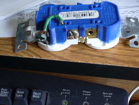

First let me state , THIS IS NOT FUNNY ,
it is DANGEROUS,
the house sold for 1.2mil. but the owners figured out how to save a few bucks on the old wiring. This could fool a three prong tester

that little trick could fool a plug-in tester ! The inspector isn't going to take things apart if his test reads OKand now, anything metallic in the system could be energized the pics about three years old,"

That trick must've been in some DIY'er mag or book or something long ago, or every half-wit Hardware store "expert" told people how to do this. You know, the same ones who sold people 30A fuses because the 15A ones were blowing.
I see this all the time.
If you walk into a house that is older than...say forty years, and there is no evidence of updating in the home except for the three wire receptacles, then they are either wired like that or there is nothing on the ground.If you haven't drawn blood today, you haven't done anything.

"what does a electrician $" BS that has turned into a pissing contest about everything electrical.The setup in the picture was done by an electrician who did exacty what the "knowledgable" HO told him to do , and everybody involved should be fined or banned or lose their Real Estate license !"
