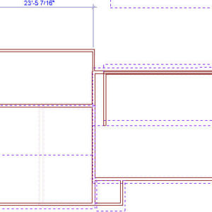

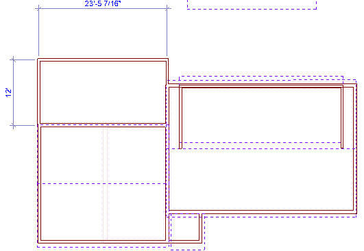

Okay, I’ve got a cape-code house with a 1-car garage.  I want to slap on a 2nd car garage onto the side of the current garage.  That’s not the tricky part.
I then want to put a 12×24 addition BEHIND both garage units.  That in and of itself isn’t the hard part.  It’s how to tie the roof in.
I have two choices as for the addition (other than don’t do it):
1) Since the house “floor” is about 2′ above ground, while the garage is on a slab, I could have a step-down addition.  This would allow a 2′ drop in the roof, assuming I could somehow tie it into the back garage wall (in other words, the back of the garage has a height of 10′ from the ground, so if I kept the 8′ wall addition height, I’d have a 2′ difference).
2)  If I keep the “floor” the same, then I don’t know what to do as far as the roof goes.

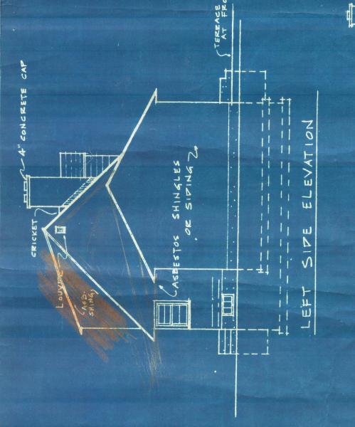

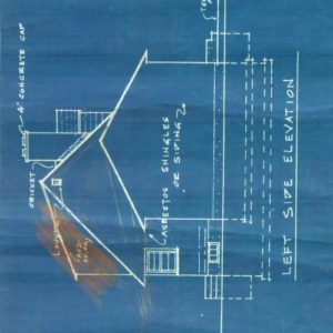

I’ve attached a few pictures of the CURRENT house (one from the original architects drawings/plans) to show the “side” of the house that I have to deal with.

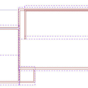

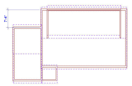

Overhead shots of current and proposed floor plans

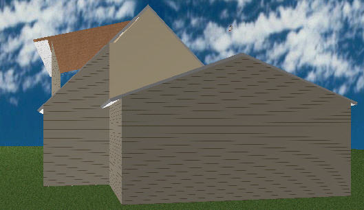

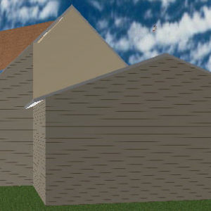

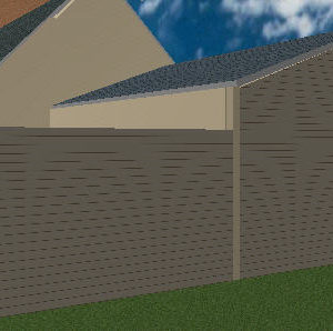

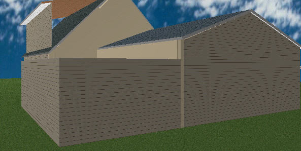

Side view of what I’d deal with assuming a “step down” addition.
talked to one builder so far who said it would be better for resale if the floor in the addition were the same.  But due to the roof, he’s suggested that we remove the entire roof from the garage and build new trusses to put the garage roof height, ALMOST the same as the current roofline on the house, thus giving a large bonus room above both garages (accessible through the “office” in my 2nd floor.
Downside to that is obviously cost, I have NO way to heat/cool a bonus room (the addition will be fun enough as it is–probably have to go heat pump), and the cost.
But any suggestions are welcome.  I am having another contractor come over this next week to give ideas.
Odds are, an architect will be needed, which is fine, I’d just like to know what ya’ll think.

    In my opinion, making the roof look right on an addition is what makes or breaks it.  And it's so easy to save money by tossing up a shed roof, some 2/12 piece of junk and rolling on.
    Coming from a guy who just tore the entire roof of his house, I'd suggest you do the same with the garage.  You are framing a lot more new roof than you would be throwing out anyway, so it's not a big deal, especially if you are doing the work yourself.  This will give you the oppurtunity to tie the garage/addition roof into the main house in some way that doesn't make it look like crap.  Depending on roof pitch of the main house (it looks pretty steep maybe a 12/12), you could gain even more space above the garage - maybe a loft looking down into the back addition...hmmm...that sounds pretty cool.

      We'll have to submit plans to an architect and get stamped to spec out the trussing that would be involved with removing the old garage roof to make it a 12 on 12 (just like the current roof on the house).
