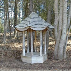

how would you frame this???
Piffin | Posted in General Discussion on April 22, 2003 04:58am
It caught my eye and got me to wondering

    2. srvfan | Apr 22, 2003 05:24am | #3
      What did you use to cut the 2x6 at such a angle on the rafters?  A table saw or something?
      1. RalphWicklund | Apr 22, 2003 05:47am | #4
        Probably used one of those archaic museum pieces that seem to be rapidly disappearing from the "carpenters" tool box.
        The Handsaw.

        2. Piffin | Apr 23, 2003 12:09am | #12
          Handsaw is right but I didn't build it. Sorry if I misled anyone. I just saw this on a Sunday walk and it caught my eye.
          youse guys dat tink I posted de ansahr too soon didn't halfta look now did you?.

      Looks like an engineer got let loose.
      I wouldn't frame it like that, would you?

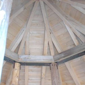

      1. Piffin | Apr 23, 2003 12:17am | #13
        wood eye?
        I honestly don't know. I saw the thing and had to ask myself, "I wonder how they framed that swag curve into it so consistently."
        Then I walked over and looked.
        They cut the swag in the fascia and led to it with the twin rafters which must have been nothced deeper than the hips - oops maybe not. Joe Fusco has all those formulae and drawing for calculating hip lift cuts - maybe they forgot to figure and when they tried to sheathit the swag happened accidentally and they had to fit the fascia to the natural curve.
        Hmmmmmmmm....

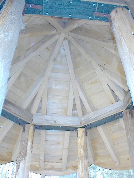

        1. calvin | Apr 23, 2003 04:32am | #14
          8 rafters and thin sheeting?
          can I look now?__________________________________________

          1. Piffin | Apr 23, 2003 05:25am | #15
            Loike arrange the sheet so it drapes just so and spray it with epoxy?
            go head an look.

      GoldenWreckedAngle | Apr 22, 2003 08:53pm | #10
      Uh, hello... can somebody say overkill?!!! Let me guess- is this a shot of Frenchy's well cover?
      I can't see any detail on how the roof timbers are attached to the collar beams. Any insight into how they addressed up lift there Piffin? They certainly took care of it where the collar beams attach to the posts.
      I'm not sure this is actually a well cover as you suggest. Judging from the construction I think it may be the tip off an antique battering ram or something.
      All criticism aside- I'm actually pretty impressed - Looks sharp. (literally)

  2. andybuildz | Apr 22, 2003 01:04pm | #5
    Piff
       Ya coulda waited and given us a chance man....lol
    I was gonna say skip sheathing steamed and bent.
    That photo gave me a good idea though. I happen to find buried on my property an old artisian well buried in weeds with a decaying old wood shake roof bout four feet off the ground.
    Been thinking of how to restore it. Now I know...one day when I have nuttin' ta do....lol
