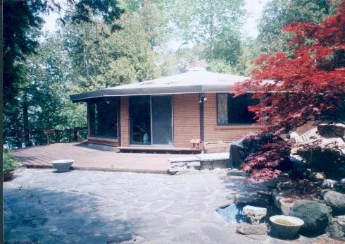

Contractors in my area of Ontario are suggesting tearing off the old roof, spraying in 4 inches of faom insulations, building up a new roof structure a few inches on top of the existing one for allowing ventilating, adding the roof sheeting, plywood?/OSB?, then applying a membrane before applying 35 year shingles. I'm told that the membrane will be self sealing around the nails. If any moisture does make it's way in then it would hit the foam and run off. The faom cannot be moved around by squirels as well, although I'm not going to invite them or any of their friends in.
I'm not in this business but hearing it from a few contractors have me belieiving it's the way to go, in addition to $$$...
An to add a little complication the house is octagon shaped.
I'd be interested in hearing what you may have to say about this approach.
