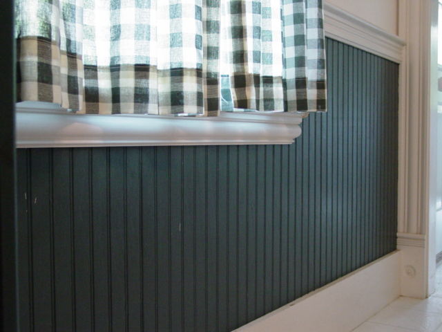

  4. KGambit | Feb 06, 2004 11:53pm | #16
    Ron,
     It sounds like you are using Georgia Pacific Ply Bead panels. I have used them quite a bit, and once they are painted they look great. A few tips for ya, be careful about the sheets you select. I don't think there quality control is all that great, because many of the sheets are not routed deep enough. A good sheet will have a fully rounded bead, make sure all the beads are fully rounded over; because one side of the sheet might look good but the other end may have several "flat" beads. Also many sheets will have a lot of "tear out" on the face veneer.
      The tear out is not as big a deal, wood putty and a light sanding will hide it, but if the sheets not fully routed, the panels will look terrible once painted. (sort of like the cheap paneling of the 70's)
     I generally go right over the drywall using liquid nails on the back side and nailing into the studs, spacing nails every 8 inches or so. For covered porches I  will strap 12" on center because the product is southern yellow pine and will bow if not held securely.
     Work right up from the floor and place your baseboard over the sheet, this will help hold it flat to the wall. Also to get more out of each sheet I will generally (for an 8" high baseboard) start 6" up from the floor and use scrap underneath along the floor for a backer to fill the space.
     I like to cap it by using a 2 piece chair rail, I will nail the chair rail directly over the sheet then place a cap piece over the top to hide the sheet product. This makes the chair rail stand out more and I think it looks nicer. Although depending on the rest of the trim in the house this may not work.
     As far as height goes, a general rule is 1/3 the height of the wall, but your eye should be the determine factor. Also if you are doing a kitchen an nice thing to do is to cut the sheets 6' and top it with a plate rail instead.
     I posted pics in thread# 32459.2 if you are looking for ideas. (I'd repost them here but I am running out of space! I have to figure out how to delete old attachments!)

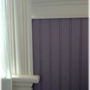

      1. KGambit | Jan 14, 2006 05:55pm | #19
        Dan,

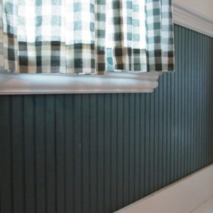

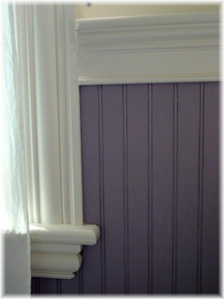

         Here you go. I haven't been on this forum in a while, I had to search for them! I've done two covered porches with this beadboard as well. It looks really good painted. The only thing I have noticed is the beadboard on the two covered porches seem to attract dirt. I don't know if it's just the way the house is oriented on the lot or from the beadboard it self. I don't understand! I cut it twice and it's still too short!

          1. KGambit | Jan 15, 2006 08:08pm | #21
            I use Georgia Pacific's "ply-bead". It's basically a 4x8 sheet of 5/8" yellow pine plywood, with beads routed on the face. Once installed it has a solid feel and you shouldn't get that 'hollow' sound like you do with other thinner sheet products.
            I installed mine in a similar fashion to the article you mentioned with a few differences.
            1) In the photo's I posted I used an 8" baseboard with a 1 1/2" cap on top, (not pictured). So I run the sheet of ply-bead down to 6" above the floor. When all the ply-bead is up I cut 2 or 3 inch wide strips with the left over scrap, and place it on the floor to give me solid nailing. The baseboard is then nailed over the top of the ply-bead. This obviously makes the baseboard stick out more, but it allows me to use a full basecap, and looks a lot better, (to me anyway). All the doorways are cased with 1 5/8" thick plinth blocks, so I had plenty of depth to work with. My approach may not work in modern houses with the thin clamshell mouldings.
            2) Around the windows I used the same technique as the article did for the baseboards. I routed a rabbet on the back side of the window casings, so instead of butting the ply-bead up to the side of the window casings, it actually slides under the casings, by a quarter to a half inch. There are a few advantages to this. First you will never see a gap between the window casing and the ply-bead. The ply-bead and the casing can move independently of each other for seasonal movement and a tight fit is still achieved. Also you don't have to be as exact in fitting the ply-bead. You make the rabbet the exact depth of the ply-bead and a 1/4, 1/2 or 3/4 inches wide. So when the window casing goes on you have a little 'play' room under the moulding.
            3) For the chair rail I used a two piece set up. I install the ply-bead to just under my finished height. Then I install the chair rail over the ply-bead; just as I did the baseboard. I then put a 3/4" cap over the top of this to cover the sheet product. Again, this looked better to me. I did a bathroom recently where I routed a groove in a piece of 3/4 oak for a chairrail, because the room was small and my other method would have stuck the cap out to far.
            I hope this helps, and I hope I didn't go to over board with my explanation!I don't understand! I cut it twice and it's still too short!

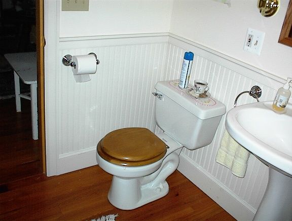

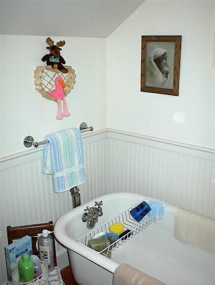

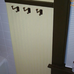

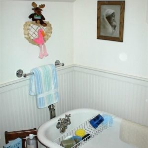

            NickNukeEm | Jan 16, 2006 03:11pm | #26
            I used it on a bathroom remodel last year.  I used the cellular PVC panels with a two part chair rail.  The bathroom was a standard 5x8' with bathtub/shower along back wall.  The beadboard did not over pwer the room, even though I wrapped it over the sink backsplash.  Of course, the client has the final word...
          7. KGambit | Jan 16, 2006 04:56pm | #27
            I used red oak bead board in a small bathroom remodel last year and it looked pretty good. I lined the chair rail height to match the height of the backsplash on the vanity, to keep one clean simple line around the room. It came out really nice.
             For the chair rail I used a piece of 1x4 oak, with a simple round over, and rabbetted a slot in the back to slide it over the beadboard. (To keep the profile as flat as possible, because it was a real small bathroom.)I don't understand! I cut it twice and it's still too short!

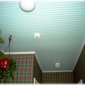

        2. BryanSayer | Jan 17, 2006 12:12am | #30

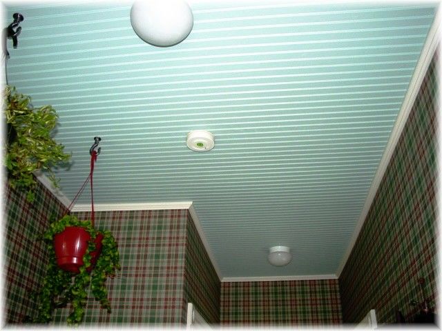

          I want to re-do my covered porch this spring. What type of beadboard did you use for the ceiling, and how did you install it? Can you install directly to the ceiling rafters, or is an underlayment layer necessary. I'd love to find something factory primed.
          1. KGambit | Jan 17, 2006 01:06am | #31
            As I mentioned in my other posts, I use Georgia Pacific's ply-bead. It's a 5/8" thick yellow pine plywood, with the beads routed in one face. For the covered porches I've done, I strapped over the ceilings joists, at 12" OC. It doesn't come pre-primed, but it doesn't take long to paint.
            Also for covered ceilings, I pre-finish the sheets. I prime the sheets, front and back, and paint the finish color on as well. After wards you just have to touch up the nail holes.I don't understand! I cut it twice and it's still too short!
