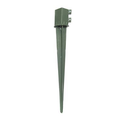

    Have you tried steel fence post holders - also called fence spikes.
    Available at Home Depot, cost about 12 bucks.
    the spike has an adjustable holder into which the (now shorter) fence post is screwed.
    You can use a stringline or laser to set your fence line
    Make sure the homeowner takes responsibility for the exact fence location
    1. calvin | Oct 05, 2010 06:43pm | #5
      If this is what you are suggesting..........
      The picture below is of a post spike from HD.  Sure, the stake goes into the ground maybe 24", but the fastening point for the post is only about 4".
