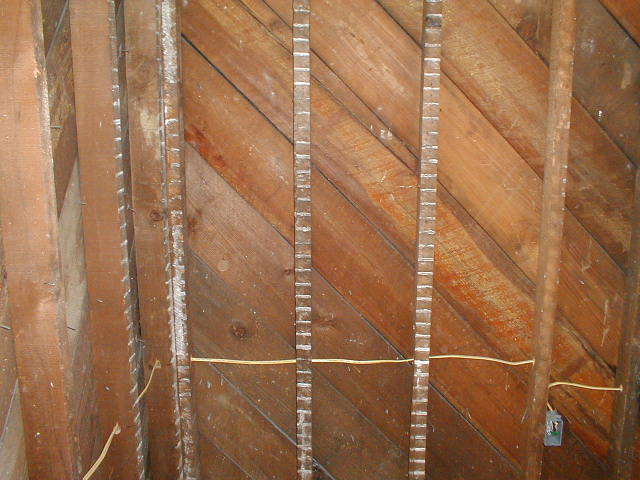

I just opened up the kneewall that is over the second floor of my 95 year old tutor style house in the Philly area. I was able to access it by taking out the back of a third floor closet.
The rooms on the third floor are framed with 2x4s on the side, so there is only limited space to put insulation in. After much thought about how to do this I think the best appoach is to put in R-11 insulation (pushed in so that it can fit the 2in cavity), then put up a sheet of foam on the outside. The foam will give me another R-7, plus it will hold the fiberglass in place. It will also allow me to use the kneewall for storage since there won’t be stray fiberglass on the wall.

If so, then I would skip the fiberglass batt. If you try to put the fiberglass into the small 2x4 done sideways cavities, not to mention the plaster smashed in thru the lath, you won't be able to smush the fiberglass enough to get the foam down to the studs. Just put the foam in over the studs and call it a day. To be fancy, you could seal the top and bottom openings at each stud cavity with touch foam. Wiring later won't be a problem. Just get earmuffs for when you keyhole saw the squeaky foam.
Alec
Well, Yesterday I did the insulation. I sistered on some 2x4 to the existing 2x4 studs (to make 4x4). That gave me enough room to put the R-13 fiberglass. Unfortunately, each cavity was a different width, and none was 14.5, so there was a lot of cutting to do. While I had the wall open I put in two electrical boxes and fed them. Then I put in the 1/2in foam polyisocyanurate over the studs. The trouble came when I tried to secure it to the studs.
I tried to use a drywall screw to secure the foam, but that didn't hold. The foam has no strength. So I considered what to do and decided I should staple them, and use a luan strip to hold the staples from penetrating too deeply into the foam. Problem was I only had staples that were 7/8.
Went to Home Depot and picked up a box of 1 3/8 staples, got home (30mins each way), and realized they were 7/8! I hate when that happens. Ended up cutting 1in strips of 3/8 plywood scrap, and using my finish nailer to put in 2.5in nails. That now holds really well.
