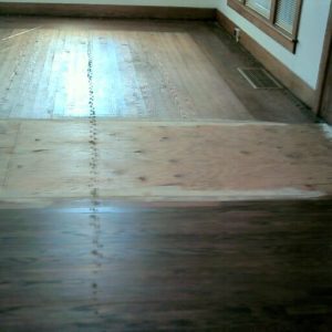

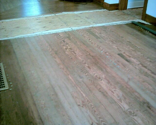

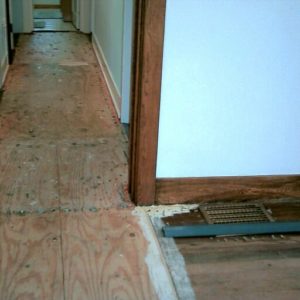

I’m just finishing this floor project up. Thought documenting the repairs might help someone in the future.
These pics show what I started with:
Ditch

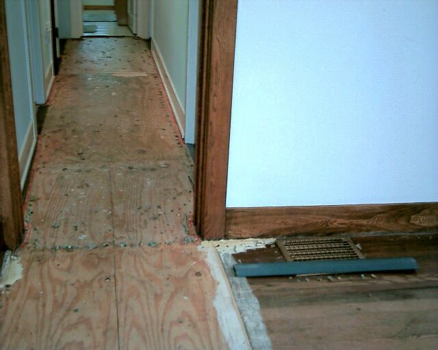

  1. luvmuskoka | Sep 12, 2002 01:54pm | #1
    As is obvious, someone removed the hardwood in the hallway, replaced it with plywood and carpeted over everything.

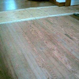

    The field in picture #3 shows the original Heart Pine floor (from around 1900), which at some point was surrounded with 2-1/4" oak. The installers built nice herringbone details into the rooms.

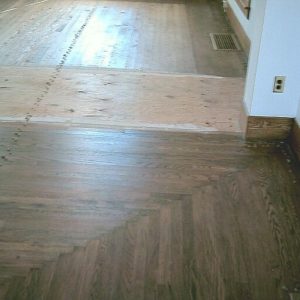

    1. luvmuskoka | Sep 12, 2002 02:03pm | #2
      Inspection from the basement revealed 2X4 scabs attached to the joists in the hallway and held up above the original joists about 3/4". I assumed at the time that they held the scabs up 3/4" to save a sheet of plywood......wrong.

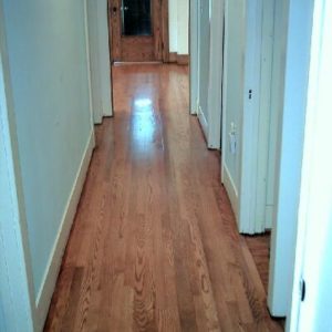

      1. luvmuskoka | Sep 12, 2002 02:27pm | #3
        After removing the plywood I discovered some serious settleing. There is a wall directly under the center of the hallway with a beam which supports the joists. The walls on either side of the hallway were however not supported, and subsequently settled. Mono posts had been installed, by whoever did the repair, under each wall to stop the settlement.
        This picture reveals the extent of the settleing. I have installed 2X8 sisters which rest on the original beam. The sisters were pony nailed with 6" pole barn spikes to tie the joist splices together over the beam and give me a guide for lopping the buckle off the top of the original joists.

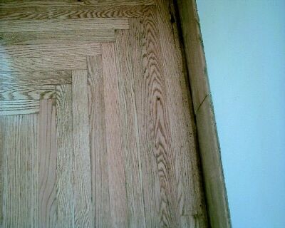

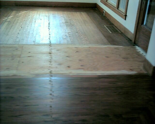

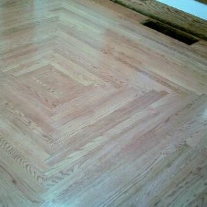

        1. luvmuskoka | Sep 13, 2002 04:38am | #4
          With the pine field taken out I installed oak 2-1/4 and added herringbone corners to match the other side of the room:

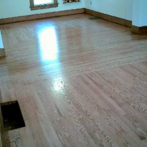

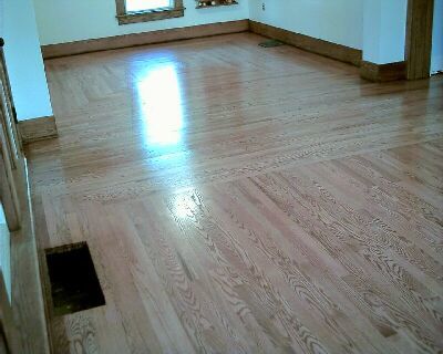

          1. luvmuskoka | Sep 13, 2002 04:44am | #6
            The floor is now being cleaned up for a new finish.

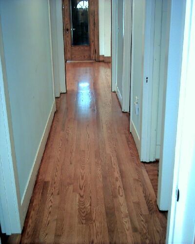

          6. luvmuskoka | Sep 13, 2002 10:56pm | #13
            Pay Day:

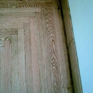

        2. luvmuskoka | Sep 13, 2002 04:42am | #5
          The flooring boards under the hall walls were trapped and couldn't be removed. I started on each side of the hall and worked toward the center. The fill came out to 5-1/8". I often sneak an oversize piece of flooring in to keep from having to rip a small amout off of a number of boards.
          By the way, the 3" board came from a bundle that was in my shop for a few years so it looks much darker but will come clean when sanded and be virtually invisible.
