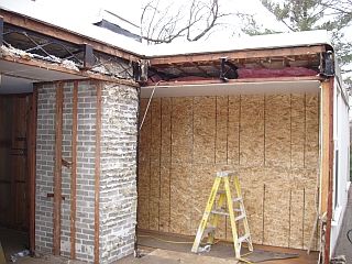

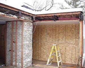

Working on a interesting job. The house was built in 1935 and was considered a prefab home. The steel panels were fabbed in Chicago by General Homes and shipped to Iowa. The price was said to be between $5000 to $6000. It seems to predate Lustron homes and the panels are not ceramic coated. The 4′ x 8 ‘ panels are bolted together with a 2 x 6 that has been rabbeted between them. It has bar joists with 2 x 4’s on edge for the roof and 2 x 2’s strapped for the ceiling. The are fastened to the bar joists with metal clips.

    We will be adding a grand room shaped kinda like a grand piano and a master suite and office above

      The lower front will be a glass curtain wall with a glass handrail above

            BarryE | Jan 18, 2007 04:27am | #28
            here's the joists:
