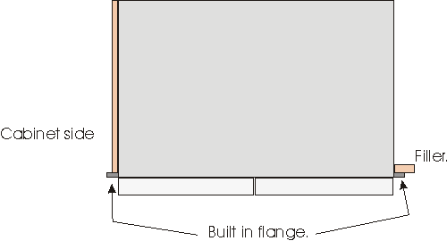

Personally I think your layout is just fine and really don’t see a problem with where your refrig. is. The only issue that comes to mind is the operation of the doors on your particular type of side by side.
Whether the doors open flush with the side of the refrig or swing past. If they swing past, you’ll need to provide the additional space for that amount. Also whether they are of the “built-in” type. If they are, they will have a flange that will rest against the cabinet. This would bring the operation of the doors pass the opening of the cabinet. All you would need is to make sure the opening was correct so the body of the refrig could slide in.View Image

JRMint,
Here’s a drawing with the built in flang.
