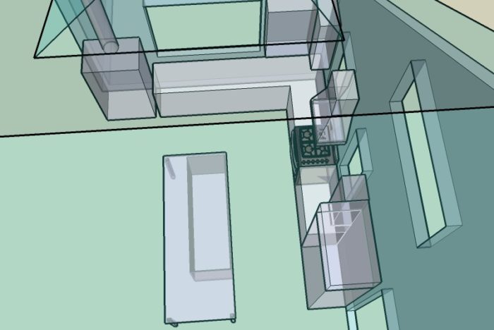

In the image here, you, the viewer, are a fly on the vaulted ceiling way up above the kitchen. The peak of the vault is about 21′-6″ above the floor, and that island, and the countertops in the L shape against the floor, are all way down there, lighting-wise.
You can gage the degree of ceiling slope when looking to the R in the pic. It is a 10:12, and its spring point height, above the sink wall straight ahead, is close to 10 feet.
Everything chosen for the interiors is “craftsman” in style, thus, a lot of Rejuvenation fixtures are around the place.
How would you best light this kitchen?
If it was my own place, 8 ft fluorescent tubes in custom fixtures. No joke.
Some form of low, hanging light for the island. Wall sconces elsewhere.
http://shopping.yahoo.com/s:Lighting%20%26%20Ceiling%20Fans:4168-Brand=Arroyo%20Craftsman:4384-Lighting%20Type=Hanging%20Lights;_ylc=X3oDMTEwMzRwMnAxBF9TAzk2NjMyOTA3BHNlYwNmZWVkBHNsawNzc2VhcmNo
I don't know if this link works, let me know.
Even though you have the high ceiling, you need to keep the fixtures low for the Craftsman feel.
undercabinet lighting, island light for the island ..
