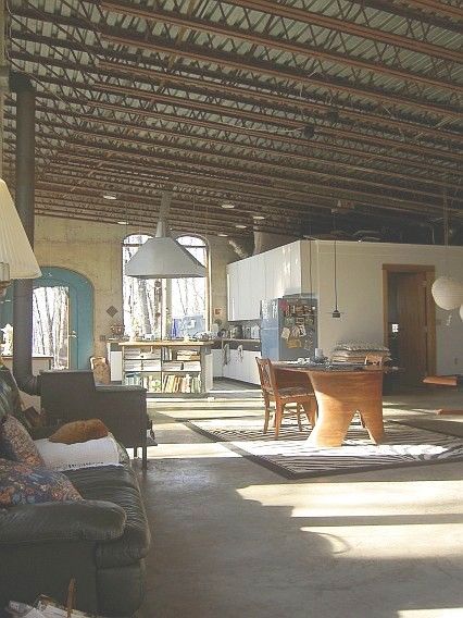

We're real happy with our arrangement. Hood is 81" off the floor, 44" off the cooktop. Fan isn't in the hood, switched in the island. Our hood was a commercial something (no fan at all), orange when I bought it at auction, but wouldn't be difficult to fabricate. Fan is a recycled 1950's kitchen vent fan, low cfm. I spent maybe $75 total, including the automotive paint.
Matching the scale is important. This is a huge box hanging here. If anybody ever noticed it, they didn't mention it. Not a focal point when there are other more interesting things to look at. Aesthetically worst thing would be to put one at or below eye level.
The downdrafts I've known were loud. Without a hood, you're going to want to move a whole lot more air. I'll be doing ours again in the next house, complete with light under the hood.
