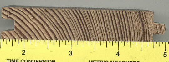

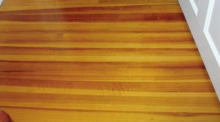

Here's a shot of what the nicer stuff can and should look like.
The endgrain photo is from somebody else here.
The disc 09 shows my own - I believe in living on it instead of keeping people off it. But you can see the grain difference in the lower grade.

Andy, "Heart Pine" is a common name for antique longleaf yellow pine, it has a lot of resin and is very dense..harder than white oak. It is old and therefore SLOWGROWN (read close rings) due to the forests being more dense back then. Yes the knots are still there.
