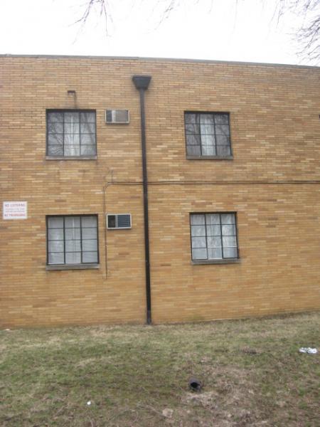

Collection Boxes would define the lowest point of the roof I suppose, here is a picture of the wall with one of the boxes:

OK -here'sthe terminology I use: The passage thru the wall is a scupper. The collector box is also known as a leader box.
From your picture, it looks to me that the collector box is too high. It should be positioned so no water will back up thru the scupper if the downspout is clogged, but instead run over the top of the box.

Is that a drain above the window?
Why is it lower than the leader box? different roof height?

I have not been on the roof, so I cannot state if the collector box is higher than the roof edge or not. Someone is supposed to climb up there this week and get some pictures, I will add the collector box and scuppers to the list of measurements ans photos.
