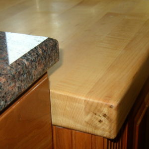

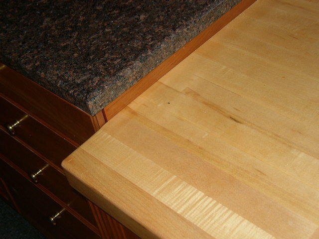

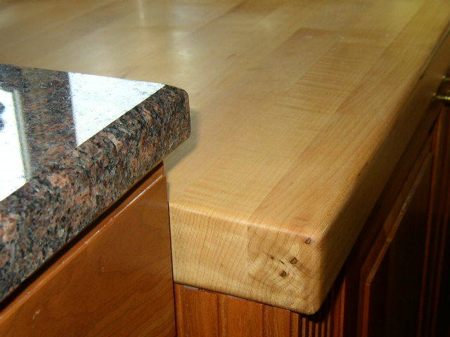

      1. WorkshopJon | Aug 29, 2003 09:11pm | #12
        "Workshopjon,   is your B Block end grain or ??, "
        44,
        No it is not. Here are some pics as well as the C & H catalog link to the page. It lists for $485. Their cost is less than $200. Just pointing out how cheaply you can buy vs. make yourself.
        Jon
        http://www.chdist.com/ecommerce/eComm?template=iCatalog/t190&cust_no=&user_id=?&ship_no=?
          Qtrmeg | Aug 30, 2003 03:26am | #13
          Those are "pinch me details", Jon, thanks for the pics.
