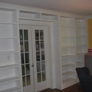

    I have made some built in book cases before and utilized mdf for the sides but never for the actual shelving.  A 5' long mdf shelf would certainly sag under it's own weight in little time without significant support.

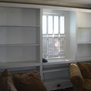

    Attached is a picture. The actual shelves were 3/4" plywood with a strip of pine glued to the front (of the shelves).  All shelves are adjustable except for the mid height one.  Thinking back, I would have used a larger strip in front to give the appearance of a thicker shelf.

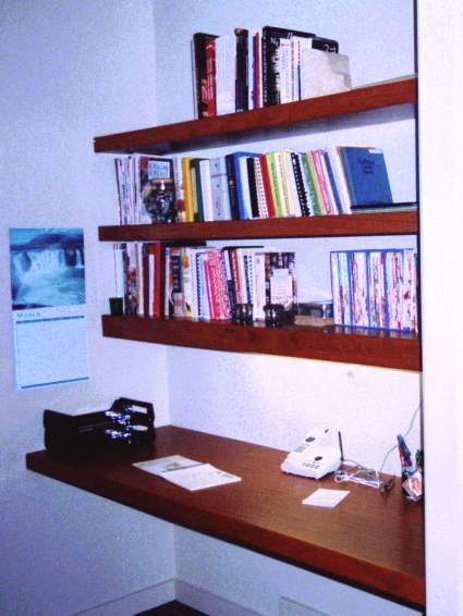

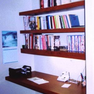

      basswood | Jul 22, 2005 02:55am | #10
      Here is a photo of what you have described (in a better size):

    basswood | Jul 22, 2005 02:42am | #8
    Here is a set of six foot shelves I made out of MDF...a cherry veneer MDF torsion box faced in 2-1/2" cherry (two layers of veneered 3/4" MDF sandwiched over an frame built of 1" thick poplar. 1" x 1" hidden poplar cleats were screwed to the walls.
    6' span and no sagging even loaded with cookbooks.

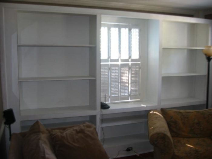

    Five feet is pretty long.  Can you divide the length and make two units?  I try not to go over 36” for shelves.  Especially if they’ll be loaded with books, etc.

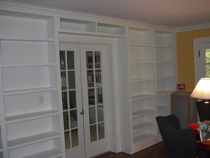

    I make custom shelving units quite frequently.  For paint grade cabinets, I use ¾’ MDF for the shelf.  I also glue a 1 x 2 piece of poplar along the front edge of the shelf.  When glueing up, I shoot 1-1/2” finish nails into the poplar to hold the piece in place, and then clamp the shelves with my Bessey clamps to make for a tight, strong glue joint.
    I nail the top edge of the poplar about 1/16” above the top of the MDF.  That way, after the glue has set, I can use a flush trimming bit in my router.  After priming and painting, you can’t even see the joint.
    I’ve attached before and after photos of one recent project.
    Good luck.
