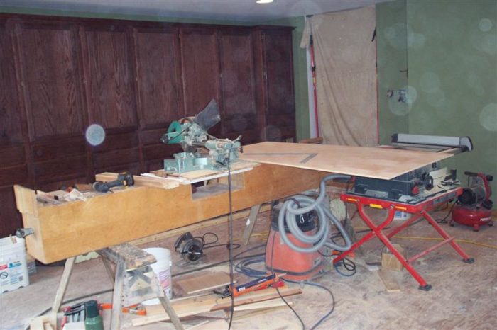

I use the board support on the end of my saw station box, pleny of room and support for long stock.

I hate to be a pain, but I would really appreciate a picture of this if possible, if not by you, someone else please?
On the ends of this box are support blocks to hold the work up with the saw base. I slide the short pt of the mitred pc to the edge of that block, hook the tape on the block and pull to the measurement.

Thanks, nice workcenter set up. Nice cabinets also, you do those? Will they get a soffit?

Thanks for the complement. Install only. Homowners purchased those unfinished from the depot @ 135 ea. Stained 'em up and now I install. Capped with crown, they didn't want a soffit. An attempt at silk purse/sows ear.
Here's my helper holding the block to the reveal while I'm at the other end of the 13'pc making it pretty. Guy is incredible, never complains no matter the job. Gotta love that.A great place for Information, Comraderie, and a sucker punch.
