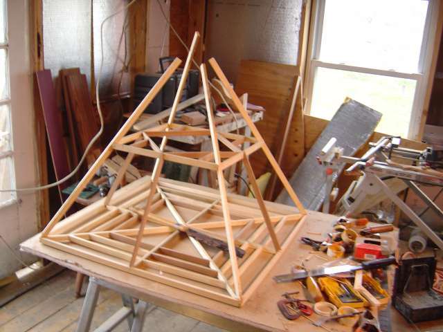

I blew off a rainy Easter playing with ideas in wood.  I just feel better seeing in 4D what I am getting myself into.
I arbitraraly chose 1″=1′ for a semi rough scale.
The challange was the hips..getting them temp braced plumb in one plane 53* on the other..I began drilling the “timbers” and glue and pegging with wood matches and bamboo skewers..that got old fast, so out came the brad nailer..LOL
I didn’t get the window and door headers completed ( except for one) due to a beck and call to a tasty Easter Dinner.
The floor joists are also outta scale, it is MUCH easier to make em the same as the other structural beams for nailing ( and I resawed a bunch, in case I screwed up some) .
The second floor will be @ 12′ ( cieling of the shop area) and acess to the sphere is through that hole.
I’ll be working on the sphere this week as time allows, for now the plan is 2 20″ dia. SS mixing bowls.LOL I will add the eyebrow windows ( one at N>E>S>W) and put a night light inside..with some slots cut under the lower bowl, the light will illuminate the “Walls”..just like floods I’ll have on the real deal. Witha copper skin and lighted from the bottom od the sphere, it will be eeeriie..and 4 eyebrows..My 77 YO neighbor will think aliens landed.
I loaded a bunch of sash weights on the second floor, maybe 40 lbs.  Solid as a rock. Even without the hips tied together. Once it is sheathed, it’ll be even better.
Happy Easter ALL…I was haveing fun..watch the Ball GAme, and I am back at it.

  4. Shep | Mar 28, 2005 03:25am | #12
    cool model- should make an even cooler shop!
    one question- does the aluminum foil go under or over the sheathing?

      PeterJ | Mar 28, 2005 04:16am | #14
      Now that's coool! Can't wait to see the sphere on top. Thrift store bowling ball would be about the right size...don't you think?
      Curious about doors / windows...inset below plane of side or proud?
      Exterior finish?
      Man, if I lived anywhere near you, I'd help you build the thing just to see it go up. PJ

        Sphere | Mar 28, 2005 02:00pm | #23
        Iam thinking inset at the head, flush sill.
        sheathed with osb or ply and standing seam copper wrap.
        The sphere will have clerestory type windows with eyebrow..try an eyebrow on a circle, outta copper..yikes.

            Sphere | Mar 28, 2005 02:10pm | #26
            Yup..being 30' wide I dont see a problem planeing 16' long lumber.  I am also thinking instead of a garage type door for wide stuff...make a drop down ramp ( like a tool trailer)  that is hooked up to a garage door opener and extra pullys and cables.
            Then I can open the 3/0 6/8 man door, hit a button and drop the ramp.  wheel in what ever and also get lots of ventilation and light.
            I'll see how it works on the model before I commit..or get commited.
