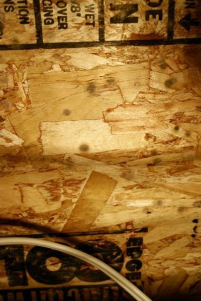

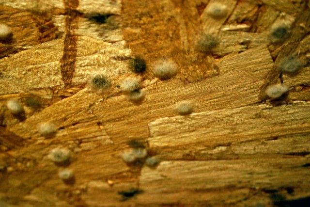

OK, O’Wiseones:
Can someone that has an experienced eye tell me what I think is mold growth on OSB? This is on the underside of Weyerhaeuser’s Structurwood OSB subflooring and it’s in every bloody place that you look. The house is, get this, less than a year old!
If you look at the attached photos perhaps someone could tell me if they’ve seen this before and if so, what remediation methods were used? I have a sinking feeling that all 30 houses in this subdivision (built over the last 3 years) could be faced with the same problem.
This house in which these photos were taken has an HRV, a High Efficiency Carrier furnace with a continuously operating fan, low humidity levels and is built over a heated, concrete floor crawlspace.
Is this stuff growing? How can you tell if it’s stopped spreading? Who tests for this kind of thing? The home is located in a town in the central part of the Province of British Columbia (Okanagan Valley). The builder of some 40 years is top notch, but a wee bit on the slow side, and is an R-2000 qualified builder as well.
What would you guys do if this was your place or a customer called you up and asked you to come by and “take a look at these black spots, will ya?”

The first thing that I would do would be to get a hygrometer and wood moisture meter and see what kinds of moisture levels that you are dealing with.
Looks like a mold or similar fungus to me.
But so little that it is not causing a problem now.
You can wash it off and monitor it to see if it comes back.
Where is this located? Is it even across the floor or near the outside walls or under kitchen or bath areas?
Since this is a "new" house it is possible that there was a big moisture load from the concrete, DW, paint, and lumber and now it is dry enough that it won't grow back after being cleaned.
But moisture testing would help tell you where you are at.

I see no reason to be concerned. Mold washes off with soap and water or a bleach solution. It is caused by moisture. Find the source of the moisture and rectify.John

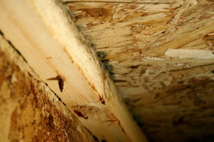

The worst area seems to be the OSB sat on top of the joists. The attached photo shows the density along that point of intersection in addition to the rust on the screws, which obviously suggests things were pretty darn wet for a spell. The investigation will continue next year!Cheers,

If you have rust on screws then obviously there is an excess of moisture/condensation. I have worked on one home where there was actually visible water on the rafter at certain times of the year. during other times of the year the temperature was higher and that was not the case. It was so bad that in their house the windows would sweat badly. What I did was to ventilate the attic space thought eave vents and ridge vents. It solved the problem and allowed their home to heat better. The attic space was so locked in that the moisture trapped in the attic could not escape. Another house I worked on has no attic vents and the house was cold in the winter and hot in the summer. The ventilating area is to be 1/150 of the space ventilated. There must be eave and vents for the upper portion of the roof. (IBC 2003 1203.2) there is also an exception which is listed at 1/300.An explanation is at http://www.iccsafe.org/cgi-bin/ultimatebb.cgi?ubb=get_topic;f=10;t=001567

Yep, that's mold. Bleach spray will kill mold. At least it killed the mold I sprayed it on at my house.

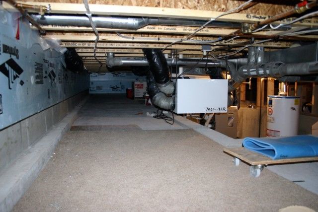

Thanks for the comments, guys. I've attached a photo of the crawlspace and by the way, it's almost the same temperature and humidity as the main floor (house is a bungalow) - dry and comfortably warm. Material under the slab is sand and drains water just about instantly, so things are pretty dry in that department. Otherwise, I can't figure out why it's where it is nor if it's growing or not. Tough to tell and I'm not sure that I want to open a hornet's nest and ask too many questions in the neighborhood at this time.
I think I'll call the Weyhauser rep - he's bound to have seen this before. Good suggestion. Cheers,

lots of good ideas here,but whatever you do get it cleaned off.i just sold a house that had about 10 spots like that in a 24" space.you could wipe off with your hand,i hadn't ever noticed them or i would of cleaned it.i sold the house iand had to declare mold,what bs.molds been with us forever but it's the new 21st century asbestos panic. larry

Those look like brown recluse spider egg sacks to me.
That looks like mold to me. To find out if it's growing, I'd wipe some of those little fuzzies off with a damp rag and see how fast they grow back or just photograph with macro lens from a certain distance and then shoot another pic from same spot in a month's time and compare pics.

Looks like early construction high humidity caused a bit of mould. You can clean and kill mould with a diluted solution of hydrogen peroxide......no chlorine (nasty stuff in an enclosed space and for sensitve people). I don't have guidelines for peroxide but should be available on Web.

Mold needs moisture. It does not look very serious yet. The problem is condensation. The OSB surface is colder than the heated space below and water condensates on the subfloor. The space above is probably heated with forced air that rises to the top leaving your floor colder than the average room temperature. If you had radiant floors then you would not have a problem.
Because you have a heated crawl space then the space above has to be warmer or else you invite condensation. If I were you I would insulate between your joists. You would lose the benefit of the heat rising but your house probably has heat anyway. Keep the crawl space from freezing but turn down the heat. The furnace and the water heater will keep your pipes from freezing.
Looks like your house is actually sealed too tight. From the rusted screws I would imagine that the floor was wet at some point. The house was sealed in and the flooring is now forcing the moisture down in stead of breathing up.

It looks like you have a conditioned crawl space with different floor levels?Looks 1/2" blue board on part of the foundation, and no vapor barrior on the floor...is that what I'm seeing?We stick a dehumidifier in a conditioned crawl as soon as the house is dried in...mold growth stops.If that is a conditioned crawl, it's done in a way I've never seen...but I'm just a SmallTannedSouthGuy<G> Oh God said to Abraham, "Kill me a son"

Yep, Snort, things are done differently up here in the Great White North. Foundation walls have 2" SM insulation (R-10) applied to them - only to two feet below grade (I'm adding more now). There's a pit for mechanicals - that's why it looks like two levels. Slab is poured directly on sand that the site is composed of - good drainage. Relative humidity levels are low as the entire crawlspace is conditioned with take-offs from the duct runs.
