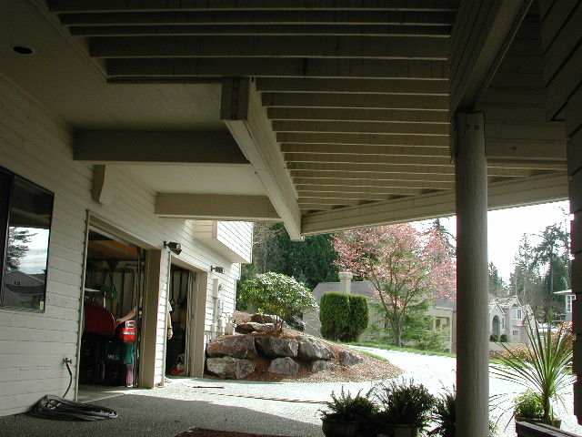

Sorry, I should have clarified: I am replacing all the lumber that I can get to easily (i.e. posts, stairs, blocking, rim joists, etc). Unfortunately, the main joists (all 60 of them) are cantilevered, which means they extend 15 feet INTO the house structure and form the main floor joists for the interior of the house. Since they are in good shape (aside from the fact that they are not treated), I am not planning to tear out half the house to get them out.

Here is a case where the builder has put cantilever on top of cantilever and the deck and wall weight has settled 2". I have to jack this up and put some support under it before it falls on somebody. Bob

Yeah, that was my original thought (the deck is cantilevered 6 ft). But after talking to the city, they were much happier to approve keeping the existing structure and just doing the decking and railing remodel, than adding a beam and posts. The latter would have required engineering, soil tests, plan checks, etc, to the tune of $5,000 before I ever lifted a hammer. Not to mention lots of haggling with the Building and Safety Dept... I decided to pass on that fun :(.
