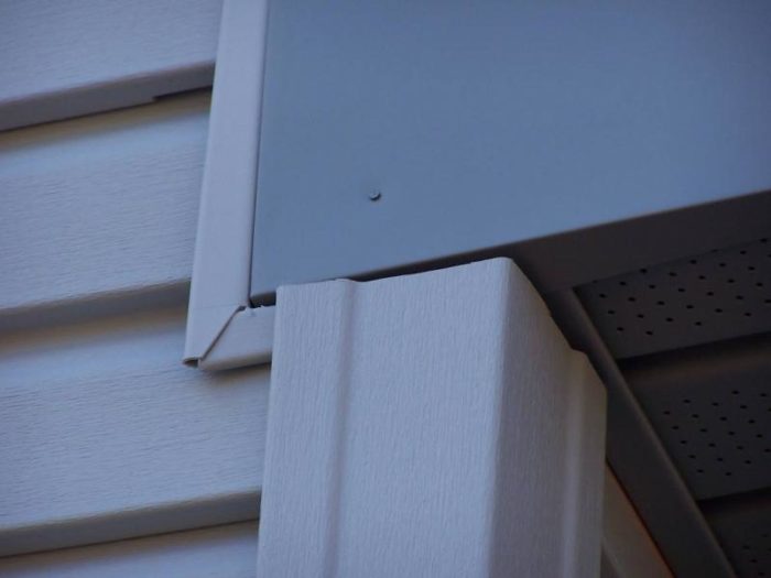

There was one pic that seemed like there was a gap betwen the trim board and faca board where water could get in. View ImageCorner_piece_sticks_out.jpg
electricity entices me
Edited 1/23/2008 6:48 pm ET by andyfew322
You're sharp kiddo, real sharp!And caulk might help that spot if it doesn't pop free. Lesson for you today - Vinyl does move a lot, so caulk does njot always stick. It has to be a very flexable caulk like geocell.
And caulk often traps water more than it keeps out as a general principle. That spot might be a place to use it though.
Horizontal siding joints should never be caulked. Remember that one.Lesson two - all vinyl - well, all siding - will let some water in. The secret to proper installation is to do the underlayment and flashing details right so that it leads water downhill and not back in again. There was a pretty good article on the subject in FHB about 2-1/2 year ago. get out your archive CD and study up!;)You passed this test fine though.

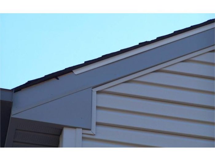

other than amissing piece of drip edge at roof on that last phot, things look good - for vinyl. the roof is not complete without the metal drip edge. That is like leaving a piece of baseboard off the room inside

First picture the small piece of corner is an eye sore. How tall is that wall? They make 12' corners looks like they used a 10', and a piece. The question is where the siding slides into the corner, are they just butted together? The channel needs to be overlapped to provide drainage.
In cases where the tops of the corners are exposed I buy vinyl surround. It looks like half a vinyl coner, the flange gets nailed to the wall and the other side snaps into a starter strip. The top of the corner and the surround get mitered for a leak free transition. They even make a crown molding that snaps into the flange for a really finished look.

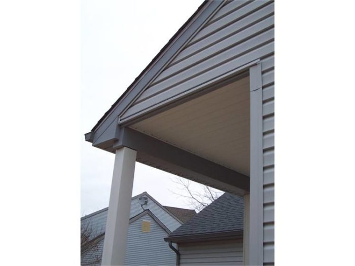

Picture 3: this is common error in vinyl siding, happens all the time. It doesn't have to happen but I think most don't care enough to do it right. The corner gets nailed on, then they stuff the J into the corner. That causes the corner to flare out like the picture. The back nail flange of the J needs to slide behind the nail flange of the corner. It doesn't flare the corner out that way.
The miters on the J look to be done horribly wrong. Having to clip the tips of the miters is a rookie mistake.
This is how J should be cut and installed, this is the bottom of a side piece. The miter is bent around and tucked into the bottom piece locking the miter together.
This is the bottom, notice the nail flanges are left long, this flashes the opening away from any holes or edges of th ehouse wrap.

Check the wall height, if it's under 12' make him get a full length corner.
The pictures of the J I posted make the miters lock together and they won't come apart. Leaving the flanges flashes the opening to a small extent.
Go and look, pull on the face of a piece of J and look past their cuts. What do you see? If house wrap or OSB it's wrong. If you see vinyl thats the color of the J then it's going to shed water away from your opening.
