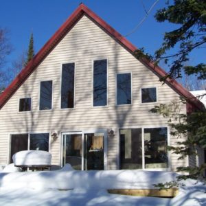

I’ve got a cabin thats built on a floating slab. There’s a porch over the door that’s on it’s own slab(see pic). The slab under the cabin won’t move as it’s a heated slab so I’m not concerned about it freezing under there. The slab for the porch is a different story though.It tends to rise in the winter and settle in the spring. The problem is the posts holding up the porch sit on the slab so this causes the porch to move up and down an inch or so. I’d like to stop this movement so I have a couple of ideas.
1. Inexpensive fix – insulate around the edge of the porch slab and try to get 2″pink foam down 2-3 feet around the perimeter to hopefully prevent it from freezing underneath due to the heat from the cabin slab.
2. more expensive fix – Brace porch roof up and jackhammer out slab, put tubes in below frost line (6′) pour new footings for posts holding up porch, then pour new porch slab.
3. Most expensive fix – Brace up porch roof, jackhammer out slab, dig complete footings below frost level and pour new footings for complete slab.
I’m guessing option 2 is the best bet but I’d really like to be able to make option 1 work or get any other good ideas.
