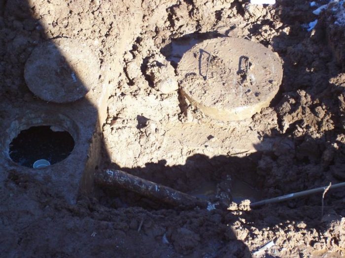

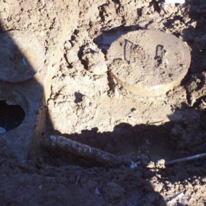

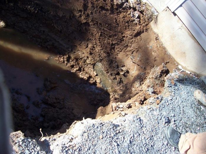

In April 2004, we had noticed water gushing out of a hole around the septic. We contacted the contractor and it was discovered that there had been 3 breaks one at the main sewage pipe into the house. In March 2005, we noticed water gushing out around the septic again. (picture attached) <!---->
As the smell (musty) in the bathroom became heavier I contacted the contractor and their plumbers were sent to my home. They removed and resealed the toilet. Not long after, the smell became so severe especially under the sink it was nauseating. The plumbers returned and caulked the pipes around the wall. <!---->
During the summer the water under the porch and around the house did not evaporate and we were finding we had a lot of mosquitoes and a frog(s) which had taken up residence. We contacted the contractor and they removed 4 boards from the porch pumped out the water and filled dirt up to the top of the boards to prevent the water from accumulating under the porch. <!---->

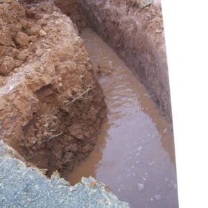

However the water around the house and hole they had put into the frost wall to repair the main sewage pipe had filled with water. I contacted the contractor and they send a mini excavator out to channel the water from the hole and around the house. The water only dropped to the bottom level of the hole. The water gushed out for approximately 4 hours and continued to drain for another 5 – 6 hours. A week later the mini excavator returned and punched another hole in the frost wall on the opposite side of the house approximately 2 feet below the last hole. The water gushed out for another 4 hours. They installed a white plastic pipe into the hole to drain off to the side. They felt there was no need to go down to the footing.<!---->
We then hired an engineer in October to help us. His conclusions were as follow:<!---->
1. Lack of perimeter Drainage of structure <!---->
2. The perimeter of the building is not transporting the water away from the structure as per the NBCC 1995<!---->
3. Not proper lot drainage ditches new the road(s)<!---->

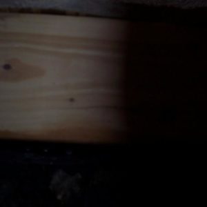

They then removed the shower. I noticed (picture attached) the boards around the perimeter of the drain showed signs of water damage. They sealed the hole with cement. Behind the shower the vapor barrier had not been sealed properly and the boards and insulation were soaked and had quite a bit of black mold. They put 2 blower heaters and dried the wood and reinstalled the insulation and vapor barrier (pictures attached). Both builder and New Home Warranty concluded the problem was due to improper insulation and the vapor barrier not sealed properly allowing moisture to enter the wall.<!---->
The clean out pipe that was located in the supporting wall and the crack in the concrete that ran along the bathroom wall had to be sealed due to the heavy earthy musty smell omitting from these areas. After this work was complete, the odor in the bathroom improved 99%.

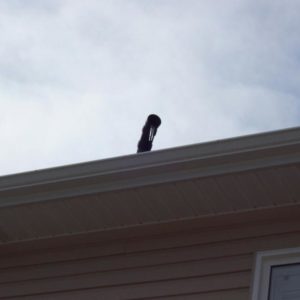

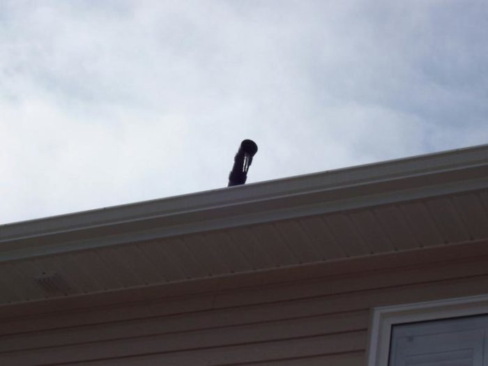

I had never heard of the OderHog, but found it.
http://www.odorhog.com/
Now this is specifically for SEWER (SEPCTIC) oders, not oders in the water supply.
Also note that it is a filter and will have to be replaced from time to time. Also note this.
"If the homeowner is experiencing an odor that originates from inside the house, the problem is most likely a plumbing problem, the OdorHog� Vent Pipe Filter will not fix that kind of problem, it may make that problem worse. OdorHogs� will only eliminate odors that originate at the plumbing vent stack on the roof."

2. SWAMP - If I understand correctly after they did the two drainage hole you had an engineer that indicated that it needed lacked proper perimeter drainage. Has that been fixed?
A house on a slab setting in a swamp is going to have moisture problem. All of the sealing in the world is not going to fix those. The ground needs to be drained. PERIOD!

Your photos re-sized, ma'am.
Good luck.
Leon thank you
You're welcome. No trouble at all.Leon Jester
Leon, glad you're here. Are you using Irfanview?
If so, just for future reference, when you go to the 'image' column to resize a pic, the pic can also be lightened to show hidden detail in a dark photo. From the 'image column' scroll down to and click on 'enhance colors'. Slide the gamma correction bar to the right and it will lighten the new image pic.
Below is a before and after of photo 1.
View ImageView ImageCheers
