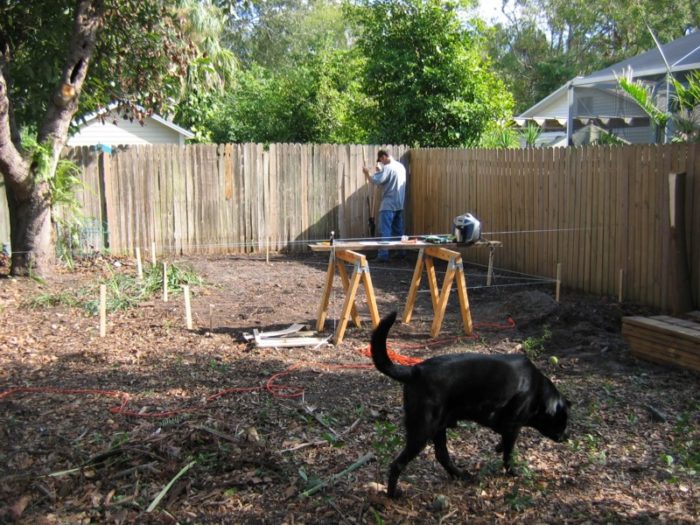

I decided to start building a shed last Thursday. Our house is about to undergo major renovations so I figured having the extra storage space would come in handy.
The goal was by today the roof was to be dried in. Somehow my schedule is off.
Anways, here’s the progress so far, I should get the framing done today:

Keep up the good work, & post more photos as you go. Their is another guy here (I wont name names) who is also building a shed. At the rate your going you should catch up with him by Thursday.
Happy Holidays!
Life sure seems simple down there in Florida (Until a hurricane relocates your shed to Kansas, of course.) Where I live, I'd have to get a permit, stay at least 10' from the property line and then, I'd have to dig down 4' through hard stoney soil for the footings.
It looks like a fun project. Better hurry! Only five more building days 'til Christmas!
Keep the photos coming!

Thanks for all your comments.

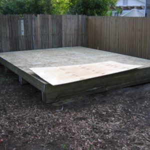

I framed the walls yesterday. Everything appears to be going ok so far. I have one issue with the corner closest in the picture. Seems the 2X floor plate was twisted (not warped). I should have replaced it, but I didn't notice it until I got almost all the studs nailed in (I was lazy and cheap). When I stood the wall it was elevated a good 3/4". Today i'll try to drop it down with a sledge.
I've never really built anything by myself, so if you guys see any major flaws or have some tips in the next phase i'd appreciate it.
I thought our city code was strict. We are allowed to build a structure 3 feet from either property line, can't be over 15', the roof cannot be 7' from the existing structure, and I think the size can be something like 600 sq ft (maybe more I was shocked when the guy told me), can't have power or water. If you want it on a slab, the same rules apply, except you have to have a permit for the slab.
Looks like I will not be able to finish my christmas project in time. I won't be able to resume until a week from Friday :-(
It will give me some time to design the roof system. I'm going with 2x6 and a 6-12 pitch. I think thhat should give me about a 4' rise on this 12 x 15 structure.
As stated previously, all comments positive or otherwise are appreciated.

2x6 ceiling joists? A lot of room waiting up there for storage.
Next time add a foot to the height off the ground and add a vapor barrier. Good place to store lengths of lumber.

hey sailfish...
looking good... any pics of the floor framing?
thanks
oak
no framing/joists pics.
Ran 2 x 8 pt 24" oc for the floor joists and added blocking-----------------------------------------------------------------------------
