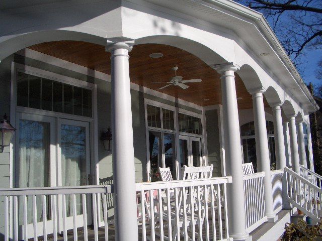

            Get hot dipped galvies instead of the usual electro-galvie roofers that the big box sells.  As previously mentioned, Maze makes HD galvy roofers.  Or you can get a new coil siding nailer and buy some SS siding nails too.  I've got both too, so I wouldn't hold it against ya.  ;)View Image

            Good point.  I really don't side very much of anything.  Yet our coil siding nailers still gets tons of use on every frame.  Just about every piece of 1x exterior trim we do is installed with them.View Image

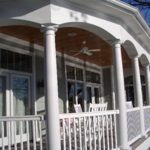

            That's what friends are for, brotherman.View Image
