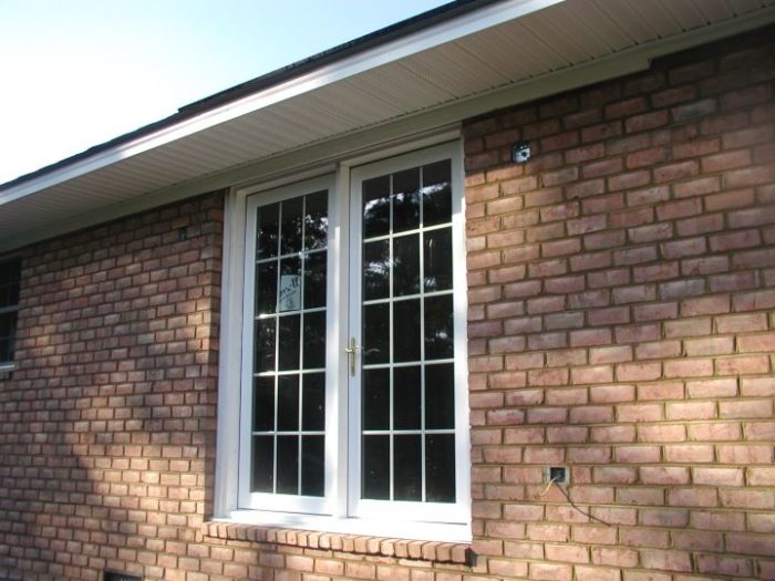

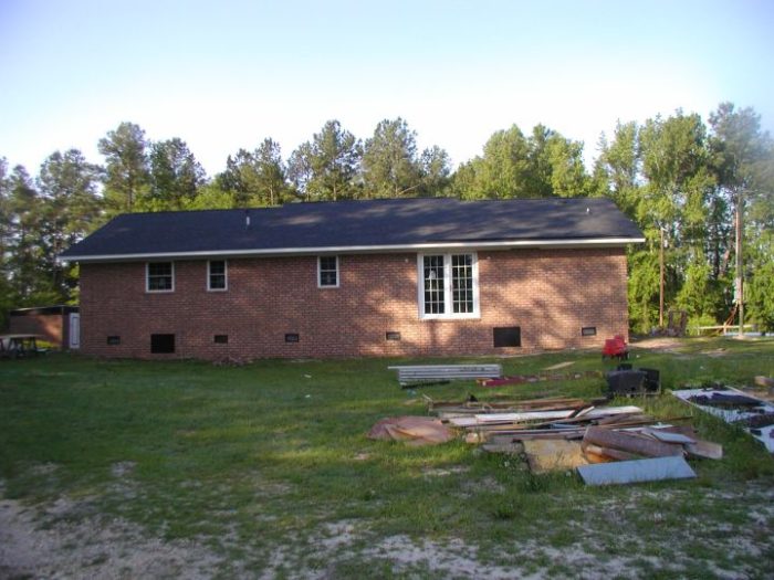

I’ve attached two photos that show the rear of a house that I’m currently remodeling. I’ve installed a set of french patio doors where a double window used to be. The patio doors will eventually lead out on to a deck.
Since the patio doors are exposed directly to the elements, I’d really like to construct some type of roof over the entrance. This would help reduce the risk of rain penetration and provide a bit of convenience during inclement weather. I’m thinking along the lines of a small gable roof, but I’d prefer not to have support posts running down to the deck since it would likely result in an awkward appearance.
I’d sure appreciate any ideas or suggestions.

If it were me I'd either leave it as is (cause the overhang will help a lot with rain unless it's wind driven)....
or I'd build a deck large enought and turn the whole thing into a screened in sun porch with a gable roof dying back into the existing one.
Any little roof without the proper support will look as if it weren't planned and a quick fix.....IMO

From the detail picture, it seems like you already have something like an 18" overhang protecting the door. This is far more protection than most doors get these days. You didn't say whether the door faces south, or what the local weather patterns are like.
In my opinion, the most vulnerable spot of a door or window is at the head. You've got that part covered in spades.
Keeping the entire door protected would require something like a 5' or 6' overhang. My front door has a covered porch of this depth, and the bottom rail sees a little rain about once a year. Snow is worse, of course, because the flakes blow horizontally so easily -- but I don't know if you get any snow at your location.
If you really want a covered and/or screened porch, then decide on that project on that reason alone. But if you're only concern is protecting the door, then I honestly wouldn't worry about it.
In your spot I'd think about what direction the door faces first. Is a driving rain really going to attack the door? Or is the weather more likely to be worse on the other side of the house? Decorative side walls that extend on both sides of the door at a depth of your overhang would add detail at less cost while shielding the door sill more often. Depending on the direction the weather is coming from. Only a head on driving rain would get to it. And how often is that likely to happen? Is a roof worth the expense?
