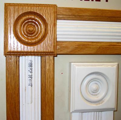

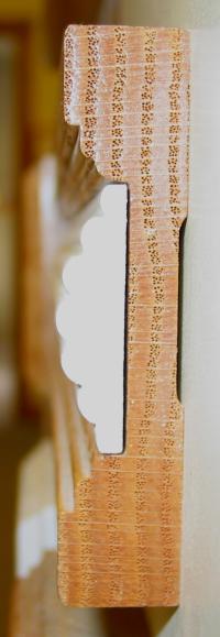

We are remodeling our house and I saw some trim I liked that is approximately 3.5″ wide by about 3/4 thick, with the center 1/3 being convex with multi-beading about it(see attached pic1 & pic2).  I have been looking at the profile and trying to find a router bit that is concave with multi-beads that could make this profile, but to no avail.  I found a full bead bit in a catalog(see pic3) showing that it can do the profile, but how would you go about it with that bit, Jigs?  I’d just buy the trim but they can no longer get it.  It would also be kind of self satisfying to make this trim myself.  I looked into getting the trim done by a mill shop but it would be prohibitive for the amount I need.

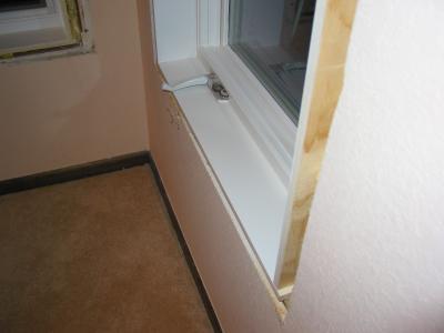

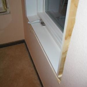

Also, any ideas for a window stool look on a casement window that are not made for a stool(see pic4).

    I wouldn't dream of making something that detailed with a router or router table.
    But then, I have a Williams and Hussey moulding machine.
    The profile you show is called reeding or reeded - as opposed to fluted.
    The base piece is more common but the reeded center is the hard part. Keep looking.

    For the stool, I would experiment with a couple of different bits to get a pleasing profile. Use 5/4 or 6/4 material or glue up a couple of 1 bys to whatever thickness. You can then cut off (rip) the profile, joint it and glue it to the edge of the bottom jamb. Sand off the glue line and presto, instant stool.

      Yeah, Ralph, I forgot about the stool question. There's nothing wrong with that casement for a stool. The profile piece just gets glued to the base piece that is there now. Open the window and a couple of quick clamps for an hour while you work on another window and voila!.

        We put stools on casements all the time, and there's no "viola" about it. Biscuits and trim screws, add the returns, then bondo and sand But hey, it's worth the effort, even you don't speak French<G> EliphIno!

    you were looking at Ferche mouldings, why don't you see how much they run a foot?
    i think running your own mouldings is the acme of endeavor, for an heirloom piece. but for casings, why not just buy it and cut it to fit.
    i remember acquiring about a hundred feet of the shell profile from your pix and it was about 3.50/ foot. well worth it for a trim job.

      Biscuits, schmiscuits.  What you need there are a few pocket screws to attach that sill - no glue, no muss, no fuss.  Pocket screws I tell ya, best thing since...since...well, they're not as good as ice cream...or cold beer...or pneumatic nailers...or a good woman making those sweet little sleeping sounds next to you...or when the customer walks up as you're loading your truck with their checkbook and a big smile...or staying up late Friday night because you don't have to work Saturday...hmmm, lets' see here...
