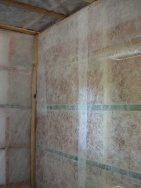

            Mike Smith photos:
            Eliminate your poly. The dens-packed cells can hold and release moisture vapor as needed. Your interior paint can be your vapor retarder.
