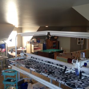

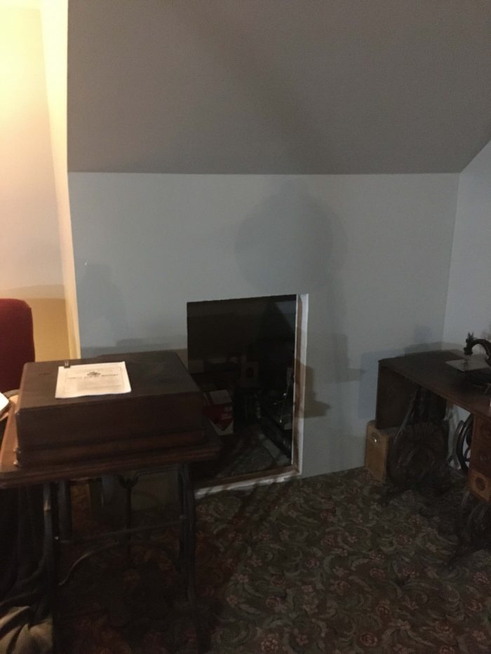

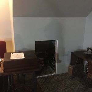

I read what I could find about attic knee walls here but could not find my situation- or the poster never responded further inquiry so the question wasn’t really answered. I live in a farmhouse style home with dormers- 1 1/2 story with a 10/12 hand cut roof . The useable attic (the 1/2 story) has the knee walls at 5 feet tall creating triangular spaces behind. The 5′ wall is sheeted on the backside with 1/2″ plywood and on the room side with sheet rock. (One old school sheet rocker got carried away and also sheet rocked over the plywood!) The area between the rafters is insulated and sheet rocked leaving nice clean the space behind the knee walls. Currently there are a few access holes between the studs in the knee walls. I want to build a series of cabinets with combinations of drawers and cupboard spaces in these walls – built-ins. The wall lengths where I want to put built-ins are 6.6′, 9′ , and the longest wall is 17′. My husband is concerned that cutting into the sheeting will destroy the shear strength these walls have. They are not load bearing. Is that a real concern? Attached is a drawing of what I’d like to have and a picture of my space- it’s a very large open room. Also a photos of what we have now- I’m in NW Washington State.

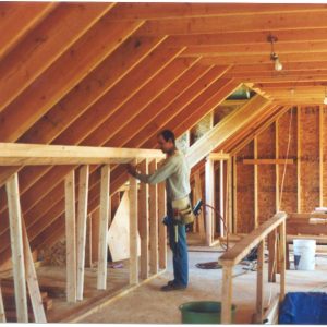

I know you said these are not load bearing but do you know if the rafters are single sticks of wood going from the outside wall to the ridge? Also, has there been a birdsmouth cut into the rafters at the knee wall?

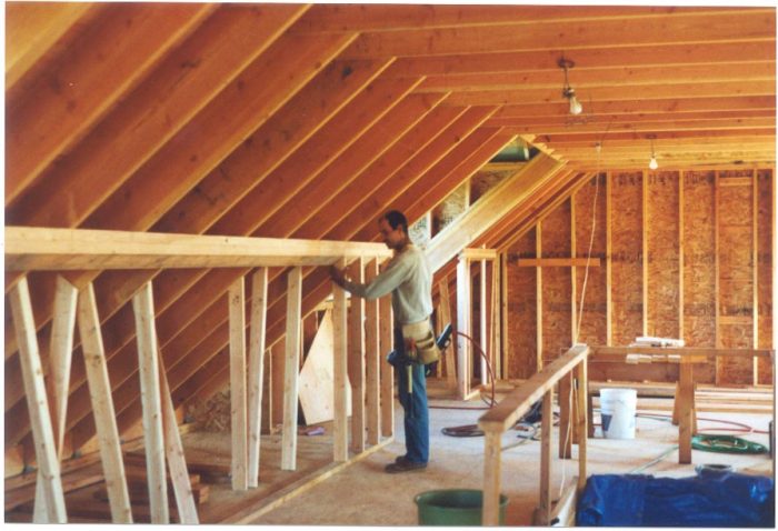

Thank you for responding. Attached is a photo of knee wall building and ceiling. Yes- single rafters from ridge to top of the exterior wall. No birdsmouths cut in rafters- no cuts at all in full length of rafters all way to top of wall.
That looks like a well framed roof. It seems like removing some or all of the knee wall would be safe. If there wasn't sheathing on the outside, I would be even more confident.
That said, I'm not familiar with the climatic or seismic considerations of your region.
I would defer to someone with local knowledge.
