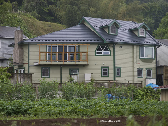

    I just finished residing my house with pre-painted ("Color Plus") Hardieplank. I did the lower half first, working mostly from a couple of stepladders, then had scaffolding put up and did the upper half (simultaneously had the roof replaced with steel).
      The whole thing took a year, working alone (including removal of all old siding and trim, and installation of rain screen under the siding). Due to the strange land footprint and tight borders, I had to stage the HP in my driveway, where I cut the boards and and sealed the cut ends, then hauled the boards one by one to wherever I was working. Our house was only 16 years old, so the insulation was still decently good and I didn't have to install foam boards; the additional depth of the rain screen was accomodated perfectly by the slightly thicker window/door trim I used.
