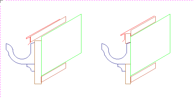

OK, we are setlled down now, did you see the GIF I posted to Grant? Has one detailed like you see it, and one the way I get them.
Yeah, the one on the left is how I've seen them attached around here.
On some of them, there's been 1/4" or 3/8" spacers behind the gutter at the rafter tails, to allow drying.
I've also seen that cove detail under the gutter, with the spacers behind. Seems to me like the 2 features would counteract each other.
