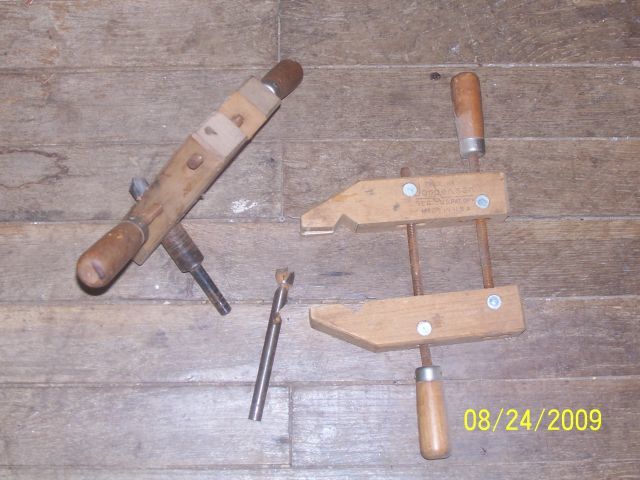

Mine's a simple handscrew clamp with Vee notches in the jaws. I clmap a pc. of pipe in the jaws as a drill guide bushing and clamp the clamp to the rail.
Can't get much simpler.Spheramid Enterprises Architectural Woodworks

Lemme dig out the parts, the pipe guide lives in my RA Drill box, and the clamp is hiding in the shop somewhere..But any 3/4" I.D. pipe about 4" long works. I use a Silver and Demming type bit or a toothed forstner type ( longer shank) and for anysize under 3/4", I cut donuts out of Teflon or UHMW plastic and slide them on the drill shank ( for say 1/2" holes).
The handscrew is a basic Jorgensen , being as most stairs I build I shoot for nor more than 38 degree incline, I can adjust the pipe/clamp to dial in a bit either way,and for tapered spindle tops, you can get by with some wiggle room. So just cut vee grooves in the wood jaws at about that angle.
A second hand screw holds the first to the rail, and my vee groove layout lines are on the clamp sides to see where the bit will hit the rail.
I can round up the parts today I think. Been cleaning up the shop and making shelves, can actually find stuff now.Spheramid Enterprises Architectural Woodworks
I can't find the other notched clamp, I think it's in the van.
But here is the 90 degree clamp and the pipe guide and bits I use most. See the scratches on the outide of the pipe? I drive a piffen screw in the clamp jaw to keep the pipe held from spinning when the frass needs to be backed out of the drill hole.
You could drill a sideways hole in the pipe and tap it, then set any angle you want, just don't let the set screws interfere.
Pretty simple jig and works great.

Here's a dense question- do you just set the pipe to the angle you want and then rely on the jaws of the clamp to keep it at that angle?
No, I have another clamp somewhere in the vans guts that have the vee groove at 38 degrees from square to the body of the clamp. Or 52 , whichever it is to drill a plumb hole on a sloped rail. Like I said, I try to shoot for that incline on stairs I build, within a few degrees either way..depending on rise/run and FF to FF calcs.
Just makes a nice walkable stair IMHO.
Notching anew clamp for an odd angle is cheap and fast, and still useable if ya have to. And I found that tapered spindles can absorb a little angular deviation in the top hole.Spheramid Enterprises Architectural Woodworks
