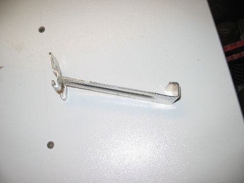

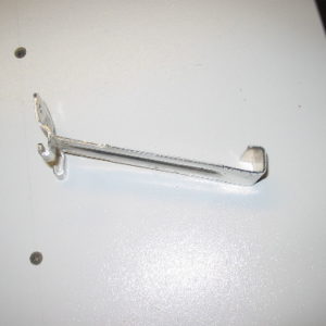

The hangers I use are made by Alcoa. We call then "universal" but that may just be a local term. I like aluminum or stainless round head screws for mounting. I use them at 24" OC minimum.Beat it to fit / Paint it to match
Thanks very much for that picture. After you swing the gutter up behind the hanger is there another screw hole that attaches the back of the gutter to the fascia and the hanger? The old gutter I just took down had been screwed at intervals through the metal to the fascia between the spikes and ferrules. Do these hangers @ 24" make additional screws unnecessary?
The back of the gutter has a lip that engages the hook in the hanger. This allows the aluminum gutter to expand and contract with seasonal changes. Once in a while, you miss getting the back to slip in properly. You don't want to screw the hangers in too tight, it can be easier to leave them a bit loose until the gutter snaps in and use a long drive bit to snug them up after. I don't get my materials from places like HD, I'm in the business so I deal with wholesalers. The cut and drop guys can make a recommendation or supply the hangers. I would stay away from the spike and ferule style hangers.When you have the gutters made up, you may want to ask them to punch the downspout nipples for you. I use aluminum pop rivets for some connections, like the nipples and short aluminum pan heads for elbows and downspouts.Beat it to fit / Paint it to match
