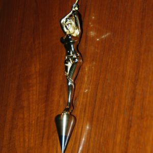

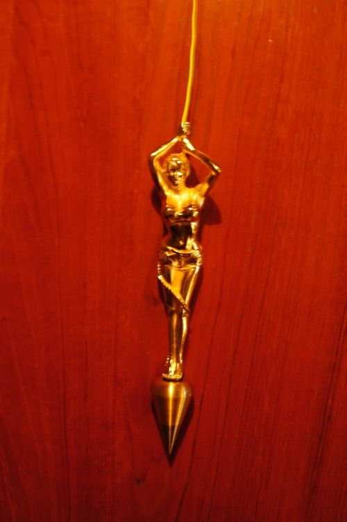

Did you see the plumb brandy picture I posted in that other thread (whatever it was)?
Missed that. Did you bolt a massive jug of brandy to a wall?
lessee if I can find it again.........
Here you go.
Aw shucks....THAT kind of Plum(b).
yessir~
A local yard closed up and I asked about "stuff".
Well, after they showed me the usual pencil, pad and nail rack, they dragged out Brandy.
I couldn't pass it up.
Now I think there's a less clad version, whose name escapes me now...............
but just as accurate for sure.
edit: Plumb Barbara.............no picture available.
and, anotomically correct.
