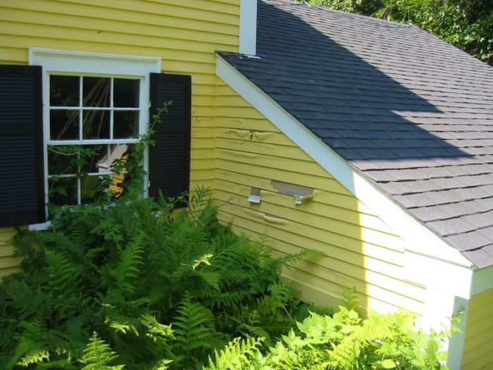

The second peeling area is halfway up a two-story wall. It's near a new gutter downspout. (see picture). The house does have balloon framing with rockwool insulation. Most of the house sits over a dry basement, but the section with the most severe peeling is over an unpaved crawlspace.
Sounds like moisture is clearly the culprit. I'd check the step flashing on the adjoining roof in photo 2363, suspecting either a leak or a lack of kick out flashing.
Inside corners, as in one of your photos, can be very damp - shady, and sheltered from winds.
The dirt crawlspace is another moisture source that can contribute to paint failure. I'd poly the floor and dehumidify.
The garage is hardest. You can't go back and install a sub slab vapor barrier, which had it existed at first, might have helped. The nearness of the wall to the soil suggests that this area may be damp. Are there gutters? The solution that comes to mind is to improve the grading so that the ground water runs away more quickly. If that's not practical, I'd consider excavaing a trench along the garage that's as deep as practical. That is, if you can go to the footings with it, and still have sufficient pitch to drain to daylight elsewhere on the property, then go that deep. Otherwise, go as deep as you can drain. Line the the trench with filter fabric, place perf pipe in the bottom that ties to the solid drain going to daylight, and fill with clean gravel.
