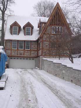

Looks like it should snow all year around your castle ... nice effect.
Artistry in Carpentry
I left for two weeks in Calif. temps back home were as low as 24 below while it was in the seventies in San Diego. almost 100 degree differance. so I got used to idea of palm trees and fresh fruit growing on the orange tress.. I came home to 5 below this morning when I went to work and over a foot of white powder on the ground. UGH!!!!!!!

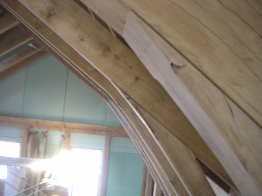

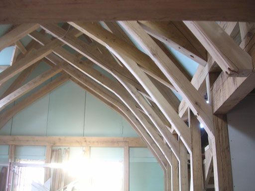

The materials may have quality, but please believe me when I say that it's far from perfection.. I could bore you for hours on all the things that aren't perfect about this place.
The main problem I have is that joints that you couldn't get a hair into opened up as they dried and now don't look so great.. And that's after I air dried all of the timbers for 3 to 4 years before I used them!
For future information, don't dry the timbers before using them.. green timbers could be used with as little as an hours worth of planing and cutting the tenions or mortices. however the dried timbers took an average of over 8 hours before they were ready to gointo place. That plus it would take at least one set of sharpenings sometimes as many as three sets of sharpening of the planner blades to plane everything smooth on the dried timbers and I could use a set of planner blades for over a dozen timbers (or more) if everything was green!
As for the checks etc. it was more a matter of placement than how dry the timbers were.. Every timber will get a check on one side of it. If I had placed timbers for minimum checking rather than the best side there would have been far fewer checks visable (but much less interesting timbers)

frenchy... the first thing that came to mind is a norwegian stave church... way beyond cool..
I can see where you'd get that idea, the gothic arch windows and the buttress braces that frame them kinda remind me of a church too..

Really nice stuff. I like the look from the road. I have always been a fan of rock walls and such. DanT
I was terrified before I started the stone work. I worried that fitting stones into each square might prove to be impossible, espcially since I had never worked with stone before. It was anything but. Each square took me like two hours or so and even the hardest, biggest square only took about four hours..
I'm no mason but the joints have less than 3/4 of an inch of motor and most are right around 1/2 So I guess my fears were for nothing...

I especially like how you incorporated the sunken driveway and the downslope to the garage. Brings a ring of truth to: 'I can't get to work cuz I'm snowed in'. Also likely to save you a bundle on gym memberships. Shoveling that drive will keep you young for decades. ;)
All kidding aside It really looks grand. In the highest words of praise heard on a job: 'You done good. Now do it again in half the time'.
It's called four wheel drive! buy one for yourself and one for the wife and just drive over the snow. Come spring and mother nature will take all of that ugly white stuff with her. (it's real easy to shovel snow on the fourth of July) Under the entryway granite is heat tape so with a flick of a switch the snow at the entryway will melt and I won't even track snow into the house!

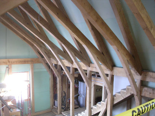

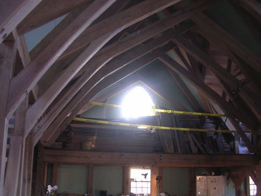

Beautiful, beautiful work. I especially like those yellow handrails LOL
EliphIno!
Confession time!
My wife tends to develop habits that are hard to break.. In order to keep her from stepping off the bridge after I took the old temporary stairs off I put those up.
sometime later there will be hand rails and such there but for now warning tape is all you get!

i just want to know what happened so that the police had to cordon off that one area with crime scene tape?
m
Mitch,
Naw, just caution tape from home depot to keep my wife from stepping off into space because she accidently forgot that I had removed the tempary stairs that had been there previously.
