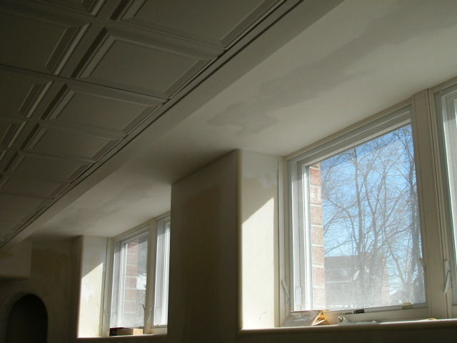

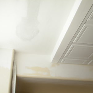

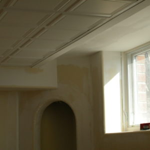

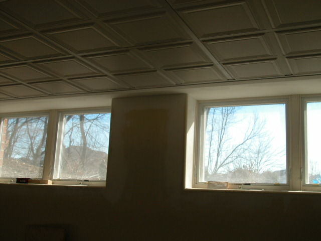

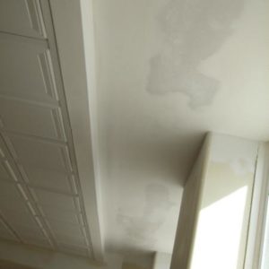

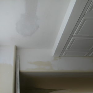

At least I think it’s clever.
In a basement … always gotta box out the windows … sometimes it turns out nicer than others …
decided to make a 2x “L” …. shot for a 1/4″ reveal at the drop line … wrapped the whole thing with drywall …. then ran the drywall into the window well.
Was gonna do 2 seperate wells … decided one continuous area looked cleaner.
Tough area to get a good shot of …
Here’s probably too many ….
     Artistry in Carpentry

    Sweeet! How did you get the rounded corners in the drywall?
    Al Mollitor, Sharon MA
      JeffBuck | Feb 19, 2004 07:46am | #5
      trimtex bull 350.
      plastic cornerbead ... spray adhesived.

    Did you lay out the drop ceiling before putting in the 2x "L"?
      JeffBuck | Feb 19, 2004 07:50am | #6
      height of the drop was figured before the L was ripped and installed.
      The L was lined up off the opposite bulkhead ... string line kept it straight ... drywall was done on the L before the ceiling ...
      then the rest of the drywall work was finished after the drop ceiling was up.
      used a 2x6 ripped down a bit for the "perfect" reveal ... first thought was flush ... then reality set in .... figured an even reveal ... what ever it decided to be in the end ... would be nice.
      As luck would have it ... thought 1/4" to be ideal ... and 1/4" it is.
      I like it .... the homeowner hasn't even noticed the transition yet!
