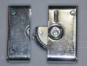

    xxPaulCPxx | Dec 05, 2011 02:54pm | #3
    Use a coffin lock, and mount a handle on the inside only.  The opposite side can be just a hex headed bolt top, in case you need to open the door in an emergency.

      not sure what that is, but remember (and DanH too) that with a pocket door, any locking mechanism needs to be flush with the face of the door, work as a pull and look good.

        The "coffin lock" is a blind panel connector used mostly in theatrical sets.  Basically this is what you need, except that most coffin locks work with a separate hex key -- kind of inconvenient, and probably a little intimidating.  However, there may be some that operate with a folding thumb nut, or you could perhaps improvise your own folding key with a hex shaft.

          Looks like it's meant to be surface mounted, curved face would make it a marginal mortise.  Then there's the key.....

            They're intended to be installed blind, either mortised or installed behind thin plywood.

            The evidently the picture is of the surfaced mounted variety....
            As the face edge is rolled and the screw holes recessed.

            If you look closely at the pictrure you'll see that the unit has half-round edges, to fit nicely into a drilled mortise.
            (And I can't figure out how you'd call those screw holes "recessed".)

            the half round edges, on the face of it-top and bottom, how's that get to the bottom of the case?
            I also see two holes, one on the face of the case, the other down inside.
            So, I guess I cannot see what you see.
          5. DanH | Dec 05, 2011 11:28pm | #11
            If you look at the right edge of the left-hand piece you can see the curve goes all the way around to the back -- a 180-degree curve -- perfect for a drilled mortise.  The holes go all the way through.
