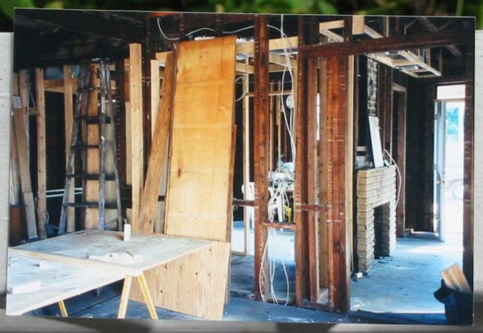

Attached is a photo of a poorly placed switchbox in my house.  As you can see, it’s inside a built-in bookcase which makes it a pain to use.  This is in a 100 year-old house, but the interior was gutted and new wiring was put in about 2 years ago (the whole house was rewired). Then the bookcase was added when the interior was rebuilt. The previous owner gave me some pictures she took of the gutted walls and it’s clear there wasn’t enough room to place the box closer to the opening due to a large number of closely-placed studs.
The issue of this switchbox came to a head as my heavily pregnant wife was trying to turn on the lights one night, so now this a my high-priority fix item.  The thing is, I don’t know of any solution other than possibly a surface mount box closer to the door.  Even if we remove the bookcase, the switch is still 20″ from the door.

        Thanks for all the suggestions.  Here's the scoop on the switches.  2 are three-way (one controls lights, the other 2 ceiling fans), one controls a light and the last controls a switched outlet.
        Looking at the framing picture again, it looks like I can fit a double-box in there, so perhaps I could stack two of those?  Not sure if that would violate code.  Or I could move the two most used switches over and leave the other two.  Another alternative might be to fir out a false wall around the door to hold the box.

          GoldenWreckedAngle | Oct 17, 2003 07:41pm | #10
          Any chance we could get a look at that framing photo?Kevin Halliburton
          1. CombatRescue | Oct 17, 2003 09:05pm | #13
            Try this.  I had to take a picture of a picture of a picture.  One note on the scale - The 2x studs, etc are actually 2" wide (they're old heart pine - very dense!).
