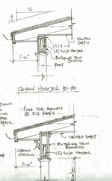

What hardware if any should be used to make the connections for the porch posts on the attached drawings? Thanks for all the help!
birdsmouth cut on the rafter? stimpson had a lot of hurricane holddowns that should work - check out the ones that do a 90 degree turn - tie the plate to the rafter
Depends on your location.
I would probably be using the Simpson CCQ or ECCQ, page 39 of the C-2004 catalog or one of the lighter duty ones on the following pages if approved by the engineer. H2.5's on the rafters
