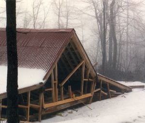

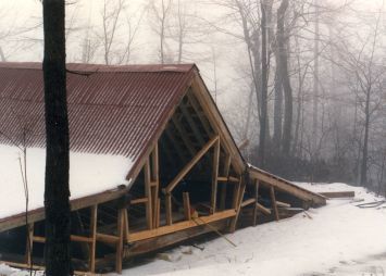

            Even better... it was in this building when it went down.  The nearby old safe caught the beam that woulda smacked the outfeed table.  Didn't bother the safe at all, which was filled with the expensive little stuff that might wander off.
            Then there's that 42" capacity 3-drum sander that's still sitting at the bottom of the driveway.  Rollback that brought it here didn't have the guts to get that 11000 lbs up here.  Only recently have I had anything to pick it up with.  Building's ready.  Needs 8'x9' of floor.  Pretty sure I can get it in there (bottom floor of the building with the translucent panels).
