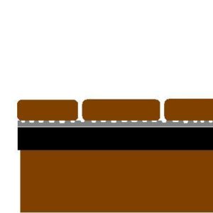

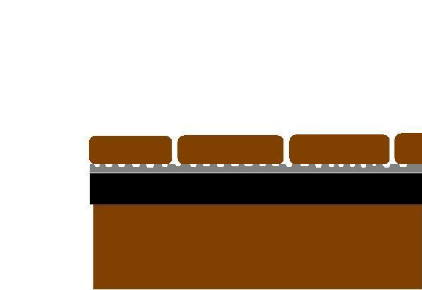

            xxPaulCPxx | Sep 07, 2006 05:59am | #27
            OK, here is another idea:
            Instead of adding a new material - like my cut timing belts for instance - why no just slightly round or angle the top of the joist?  A single pass with a router or a circular saw would do it:
            In this illustration I put two angles on it, but you really only need one that goes all the way across.  Instead of bearing on a flat face, it would bear on an edge.  There would always be an air space except for a very tiny portion where the plank bears on the joist.  A membrane would still be used on the joist, of course.  If the cuts were light enough, you wouldn't get below the treated wood... and that would be under a membrane anyway.Rebuilding my home in Cypress, CA

          9. Piffin | Sep 07, 2006 06:11am | #29
            We just can't keep you inside the box!LOLit would have to be beveled to both sides - because with one angle taken off only, the load would be directed all on one side of the joist and the stresses would make it want to twistBut other than the time it would take to work them up that way, I like it.
