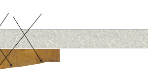

    I was going to suggest Power Grab also, and add that I shoot a couple of brads at angles to eachother to sort of pinch into the drywall.

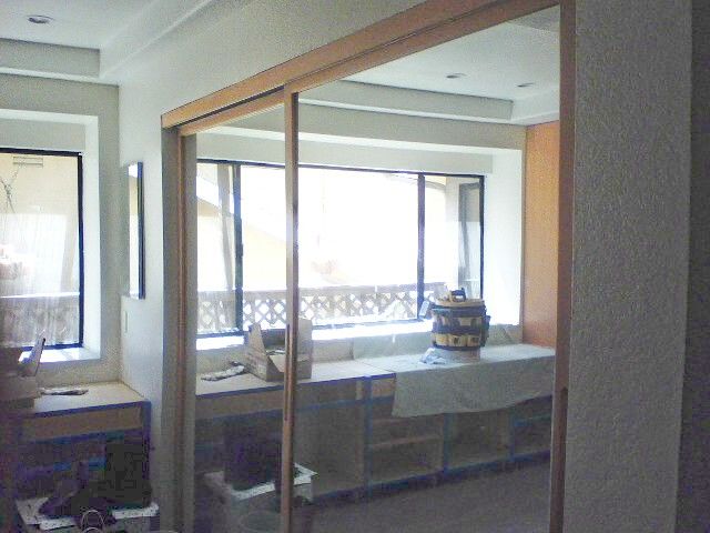

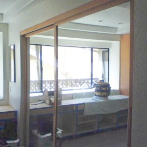

    I just used Power Grab to hang some trim pieces on the upper tracks of mirrored closet doors.  I ran a wavey bead on the back of the trim and used several small spring clamps to hold it in place while I finished prepping the doors for installation.
    The clamps were on for ~30 minutes and when I took them off, the trim was rock solid.  I think that I'm gonna really like this stuff. - lol
