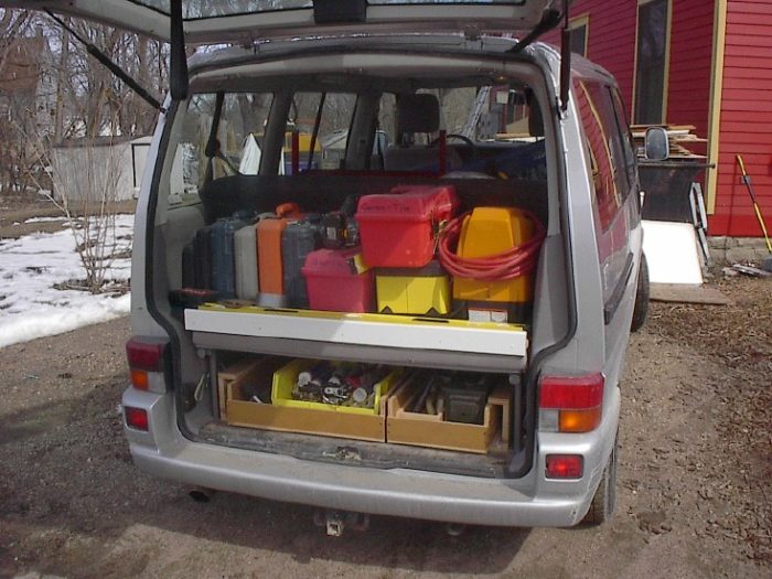

No doubt that the Thomas is a better quality unit, maybe quieter too. I do like the all enclosed feature of the little pig, though. Maybe less likely to get component damage from being banged around in the back of the van, etc. I'm not a big fan of buying cheap tools as a rule, so I'm hoping that I'm not slapping my forehead with the palm of my hand in the near future!
We've been using that little yellow "pig" for a year now. The only complaint I have is that it belongs to my apprentice (I want one). I like the way it fits into the tool case line-up. The package, light weight, and quiet operation are an unbeatable combo. The only funny thing about it is that it does not look like a compressor...sorta hard to pick out of the tool line-up...except for the hose--it is just another tool case.
