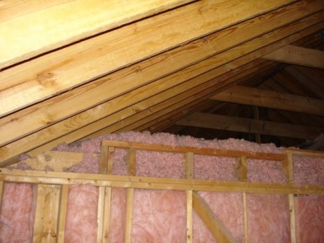

I am a recently retired guy who has a background in the aluminum industry and I have experience in home building from many years ago so i need help to know the latest technologies.
I want to improve the R factor in my attic area. My house is one story and i have a high ceiling in my living room which leave me with a “bubble structure” in my attic over that area which forms the sidewalls and ceiling of the living room area. As a result I have verticl walls of that structure which only have 2×4 depth. My current insulation is 4″ fiberglass batts so I am loosing a lot of heat energy.
I need to know the best method for increasing my R factor.

I don't know what ridge board insulation is, but my first thought is to place foam panels ( Rigid foam sheets) on the face of those studs. EPS or Foil faced polyisoanurate.
Best would be to take out the FG batts and have spray foam installed there, but that is probably overkill, price wise.

That looks like you want to be carefull not to prevent the soffit ventsfrom working - how is this attic vented anyways?
In this area of the attic there is a ridge vent.
I will watch the clearance, i have lots of room so it shouldn't be a factor.

The vertical sides of the ceiling structure only have 2x4's so the fiberglass batt insulation is only 4 inch. Effectively I have an attic surface with only 4 inches of insulation. I want to increase the effective R factor.
Should i fir out the 2x4's so i can install additional fiberglass or as someone suggested put rigid board insulation across the 2x4's.
What do you suggest?
The picture suggests that you have room in front (toward the camera) for a second framed wall. You could knock that together with 2x4, non-structural, staple housewrap or mesh used for cellulose retention to the frame, tilt it up and attached it to the top of the existing wall for lateral support, and set back 8-12 inches. Then fill the cavity with cellulose, to the top of the other wall. All the R you need.
Principle #1- Fiberglass and cellulose insulation are both hindered if they're not encapsulated on all six sides. My #1 goal would be to install some type of barrier (not to be confused with a vapor barrier) that would "protect" the back side of the insulation.You can do this with several different materials, but my personal favorite would be Expanded PolyStyrene (EPS) foam board. It seems you have plenty of room, so why not install 2-5" worth? If you can find a foam producer in your area, they can make the foam panels whatever size you want.Personally, I would install 2"x4'x8' panels and foam the joints so it's relatively air tight. This will increase the performance of the existing insulation, add ~R8 to your wall/ceiling section, and significantly reduce the air infiltration and exfiltration.

Since i have a relatively small area to Insulate can i loose pack with Cellulose to achive a good R value. I have pleanty of room i can actually make my barrier wall as far from the existing wall as practical and pour in from the top, then cap the top with 1/4" plywood to contain.
usually if you can buy cellulose, you can also rent a blower...
then you can put up some insulmesh and denspak your new thicker wall....
the results you would get from "pouring " the cells will be unsatisfactory at best
besides, think of all the fun you'd have... can you get someone to help with the hopper while you run the nozzle ?Mike Hussein Smith Rhode Island : Design / Build / Repair / Restore
yes I have a friend who can help me and I will pursue that route.

may not want to use rigid foam insulation. The BO may declare it a fire hazard. Codes vary somewhat on this issue.
Covering the walls in batt would be OK. You shouldn't have to fur out. the trick is to get it to stay in place ... which shouldn't be hard. Do you need to insulate the vaulted ceiling, too?
