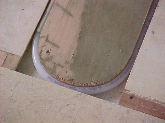

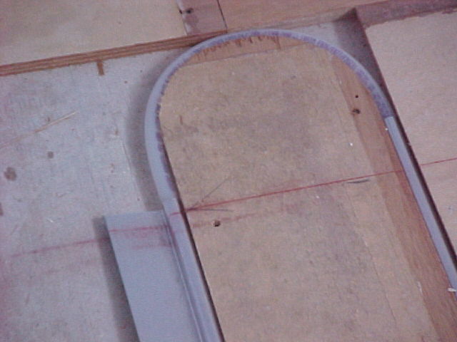

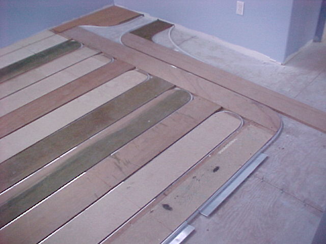

A couple of pics. I lied, too. I didn't do full outside radius cuts. Didn't feel the need. I know I put some fillers in (used waste from other cuts) in some locations for the blanks in the curve ... but not sure you really need them.
I did a floating wood floor over most of it. Tile in the bathrooms (on Hardi board).
That's great! Thanks for the pics. I imagine that the PEX has to move freely in the tracks and that you flow tested it before you put the floor on top?
Jasper57
I pressure tested before I put flooring down (using air pressure). The pex is able to move somewhat freely as it really isn't held in place or 'clamped' in any way. The warmboard allows NO movement as the tubing is held along the entire length including the curves ... where I allowed just a titch (that's a technical measurement term my grandfather used frequently) of 'flex' at each curve/switchback.
I didn't want to staple up from underneath as that seemed to me like the others found out ... a PITA. Even buying new A-C plywood and ripping your own strips was relatively easy. I laid it all out before laying down the tubing to check the layout and plan for adjustments. Once the bulk is in, you can make all your special/custom cuts and connections back to your vertical risers, manifolds, whatever.
I had a LOT of custom cuts, but you just lay it out and do each one.

re: my home made warm board .... Like anything ... pay your money, take your choice. If you have time and less money ... do it yourself warm board will cost you about $1 a sqft for the plywood ($32 or less a sheet and no shipping charge) vs. $6, but then you have youre effort to cut it and the additional effort to install. IMO it ain't a bad choice.
Yeah, it's hard to argue with doing home-built for the first couple of rooms at least, but I want to see what the HVAC guy sez. He may have some other idea altogether and, I'll be interested to hear what he says about hot water heaters vs. boilers. I suspect I'll end up doing a mixture of subfloor tubing and, err.. sub-subfloor tubing.
